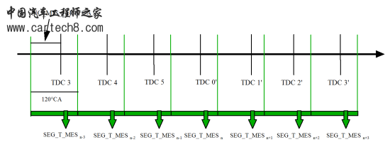

    The system checks for misfiring by monitoring the crankshaft acceleration. Misfiring causes the angular velocity of the crankshaft to drop in an angular range specific to the cylinder in question. The misfiring detection is based on the observation of this variation of segment period (720°/N CRK) for N cylinder engines.
    To compute an engine roughness value, 7 continuous valid segments are required for a 6 cylinder engine.

    Segment period correction
    The prerequisite for reliable misfire detection is accurate segment period measurement. However, the period between two TDC, at constant speed, is subject to variations due to manufacturing tolerances and off centre installation.
    These inaccuracies are systematic, so they can be « learned » during fuel cut off periods and used for compensation. By this way, the systematic error introduced by the tolerances of the target wheel is largely eliminated.

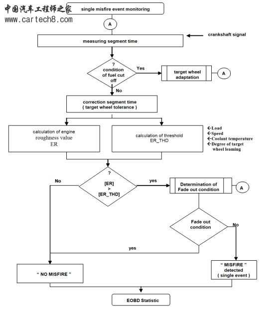

    Misfire Algorithm
    Flowchart
    OBD statistic flowchart

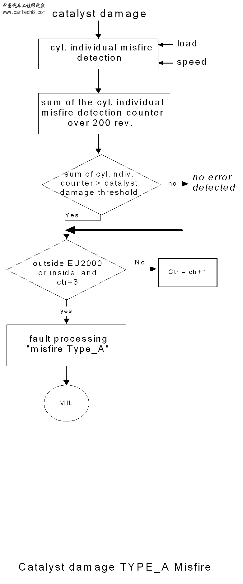

    Catalyst damage misfire(TYPE A)

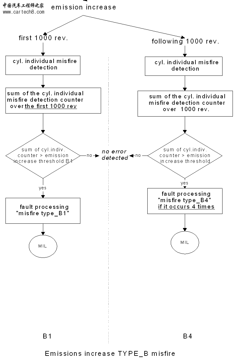

    Emission increase misfire(TYPE B)

    The irregular ( misfiring ) engine roughness ER Values computed from the segment periods measured and corrected are compared to load and engine speed dependent thresholds THD_ER. If |RATE_MIS| › |THD_ER| =› a single misfire event is detected.
    Threshold determination THD_ER: the threshold is influenced mainly by the engine speed and load. Other influencing parameters are the engine temperature and the target wheel learning degree, thus the threshold is corrected in cold coolant temperature conditions, and until a first flywheel learning is complete.
