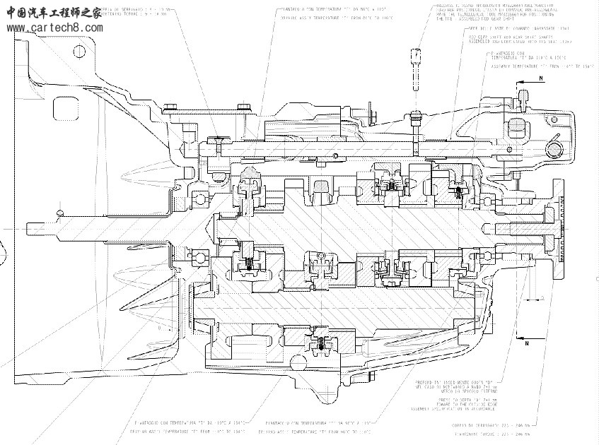

各位大虾,小弟做一项目,变速器为进口ZF 6S-400变速器,但是没有内部速比的数据.请有这资料的达人贡献一下,小弟感激不尽!痛哭流涕中.................

Gearbox ZF 6S 400.
1st   5.373
2nd  3.154
3rd  2.041
4th  1.365
5th 1.000
6th  0.791
Reverse 4.838.

    还是这个啊?
