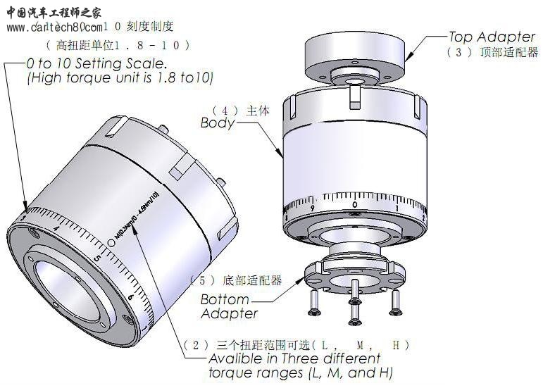

请各位帮我看看我翻译得对不对? 英译汉,是关于磁性离合器的. 多谢! 附件有图纸.
(1) 0 to 10 Setting Scale (High torque Unite is 1.8 to 10)
(1) 0-10刻度制度(高扭距单位1.8-10)
(2) Available in Three different torque ranges (L,M, and H)
(2)三个扭距范围可选(L, M, H)
(3) Top adapter 顶部适配器
(4) body:主体
(5) bottom adapter: 底部适配器

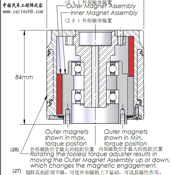

翻译-2 (磁性离合器)
请各位帮我看看我翻译(英译中)对不对? 谢谢了.
(24)
Outer magnets shown in max. torque position(24)外部磁体装置
Inner magnets shown in Min. torque position (25) 内部磁体装置
Rotating the tooless torque adjuster results in moving the outer Magnet Assembly up or down, which changes the magnetic engagement. (27) 旋转其扭距调节器,可使外部磁铁上下运动,可改其磁性作用。
(26) Outer magnets show in max torque position: 外部磁铁位于最大的扭距位置

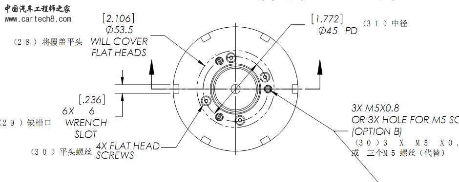

(28) Will cover flat heads将覆盖平头
(29)wrench slot缺槽口
(30)4 X Flat Head SCREWS 平头螺丝
或 三个M5螺丝(代替)
(31)PD: 中径
