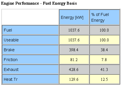

(1) The exhaust energy audit presented above is only an estimate, for following reasons
a) Useable energy at rich conditions is based on stoichiometry of usual fuels (i.e. gasoline and diesel)
b) Exhaust energy is estimated by subtracting in-cylinder work and ht. transfer from useable fuel energy
c) Exhaust energy estimate does not account for the sensible energy at intake (datum of 298k)
thus, the exhaust energy estimate is good if the control volume is bounded by the intake and exhaust
valves, intake temperature is 298k and mixture ratio is lean (or rich for usual fuels only).
(2) For mean-value cylinder calibration connect the energy audit subassembly map to the engine model
map to get an accurate exhaust energy
(1)此图中Friction是那部分热量损失?是零部件摩擦损失吗?
(2)废气损失Exhaust是怎么计算出来的?
(3)传热损失Heat.Tr是那部分传热,是缸壁传给冷却水的吗?还是缸壁传给冷却水和机油热量和?
(4)后面的那段英文什么意思?
望高手指点!不胜感激!
就是根据Engine Friction Object or FMEP Value项你提供的模型算出来的。其实就是查表,然后将bar换算为功率即可。
exhaust=(总热量(fuel)-指示功率-热传递功率)/总热量
热传递就是根据EngCylinder中指定的热传递模型和壁面调节计算出来的。这里是总的热传递,也就是你说的热量和,不过还包括传递给固体的。
(4)后面的那段英文什么意思?
就不必翻译了吧。

结果里能不能把传给各部分热量分别表示,缸壁传给冷却水的,给机油的,热辐射等!
发表于 3-3-2009 16:34:37 | 显示全部楼层
可以的,必须采用EngCylTWallSoln模型

请问楼上计算中出现fuel -10000 ?useable-10000? exhaust -10227?是什么问题
发表于 9-3-2009 10:06:17 | 显示全部楼层
你的几个数字无法和图片对应起来呀。
 楼主| 发表于 10-3-2009 07:04:49 | 显示全部楼层
回复 6楼 xingguangxiao 的帖子
应该是什么地方算错了!如果算对了后几项只和等于燃油燃烧热量!
