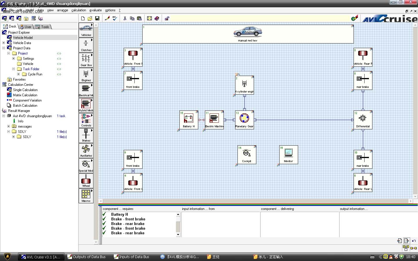

CRUISE 拷贝.jpg 我自己建了一个Cruise的模型,但是不能运转,想知道是为什么,哪位大侠能指点一下呢!数据连接发在2楼和3楼,谢谢了啊
 楼主| 发表于 5-8-2010 18:46:21 | 显示全部楼层
Outputs of Data Bus
Battery H
        Net Voltage         to         Input 0 [Monitor]
        Status - Overcharge         to         Switch [Electric Machine]
        Status - Undervoltage         to         Operation Control 0 [Cockpit]
        Status - Undervoltage         to         Gear Indicator [Cockpit]
Brake - front brake
        Speed         to         Input 2 [Monitor]
        Power         to         Input 3 [Monitor]
        Braking Torque         to         Input 1 [Monitor]
Cockpit
        Load Signal         to         Load Signal [Engine - 4 cylinder engine]
        Load Signal         to         Load Signal [Electric Machine]
        Brake Pressure         to         Brake Pressure [Brake - front brake]
        Brake Pressure         to         Brake Pressure [Brake - rear brake]
        Speed         to         Input 5 [Monitor]
        Acceleration         to         Input 4 [Monitor]
        Ambient Temperature         to         Ambient Temperature [Battery H]
        Ambient Temperature         to         Temperature External [Battery H]
        Operation Control         to         Start Switch [Engine - 4 cylinder engine]
        Operation Control         to         Switch [Battery H]
        Course Signal 1         to         Desired Torque [Electric Machine]
        Course Signal 2         to         Desired Torque [Engine - 4 cylinder engine]
Electric Machine
        Torque         to         Input 7 [Monitor]
        Speed         to         Input 6 [Monitor]
        Operating Mode         to         Operation Control 1 [Cockpit]
        Operation Control         to         Operation Control 2 [Cockpit]
        Engine Speed         to         Input 8 [Monitor]
        Torque before Flywheel         to         Input 9 [Monitor]
 楼主| 发表于 5-8-2010 18:47:25 | 显示全部楼层
Inputs of Data Bus
Battery H
        Ambient Temperature         from         Ambient Temperature [Cockpit]
        Temperature External         from         Ambient Temperature [Cockpit]
        Switch         from         Operation Control [Cockpit]
Brake - front brake
        Brake Pressure         from         Brake Pressure [Cockpit]
Brake - rear brake
Brake - front brake
Brake - rear brake
Cockpit
        Speed         from         Speed - Ring Gear [Planetary Gear Box]
        Operation Control 0         from         Status - Undervoltage [Battery H]
        Operation Control 1         from         Operating Mode [Electric Machine]
        Operation Control 2         from         Operation Control [Engine - 4 cylinder engine]
        Gear Indicator         from         Status - Undervoltage [Battery H]
Electric Machine
        Load Signal         from         Load Signal [Cockpit]
        Switch         from         Status - Overcharge [Battery H]
        Desired Torque         from         Course Signal 1 [Cockpit]
        Start Switch         from         Operation Control [Cockpit]
        Desired Torque         from         Course Signal 2 [Cockpit]
Monitor
        Input 0         from         Net Voltage [Battery H]
        Input 1         from         Braking Torque [Brake - front brake]
        Input 2         from         Speed [Brake - front brake]
        Input 3         from         Power [Brake - front brake]
        Input 4         from         Acceleration [Cockpit]
        Input 5         from         Speed [Cockpit]
        Input 6         from         Speed [Electric Machine]
        Input 7         from         Torque [Electric Machine]
        Input 8         from         Engine Speed [Engine - 4 cylinder engine]
        Input 9         from         Torque before Flywheel [Engine - 4 cylinder engine]
