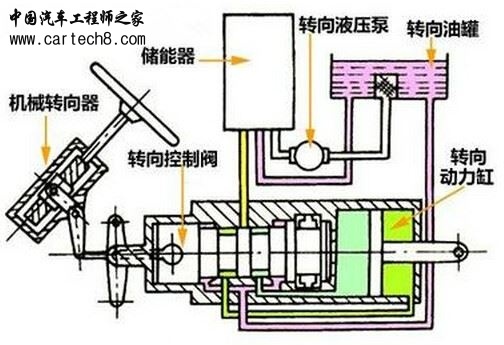

getimg.php?url=http%3A%2F%2Fwww1.autoimg.cn%2Fzx%2FBlog%2FContent%2F2015%2F3%2F30%2F2015033008474901158.jpg
  机械液压助力转向系统结构图

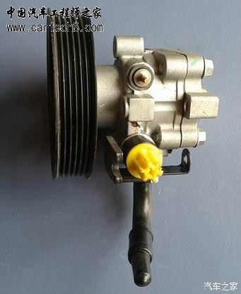

getimg.php?url=http%3A%2F%2Fwww0.autoimg.cn%2Fzx%2FBlog%2FContent%2F2015%2F3%2F30%2F2015033008474990085.jpg
  某自主车型的助力液压泵,带有由发动机驱动的皮带轮,成本不到500块(不包含转向机)

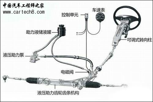

getimg.php?url=http%3A%2F%2Fwww0.autoimg.cn%2Fzx%2FBlog%2FContent%2F2015%2F3%2F30%2F2015033008475058731.jpg
  电控液压助力转向系统结构示意图

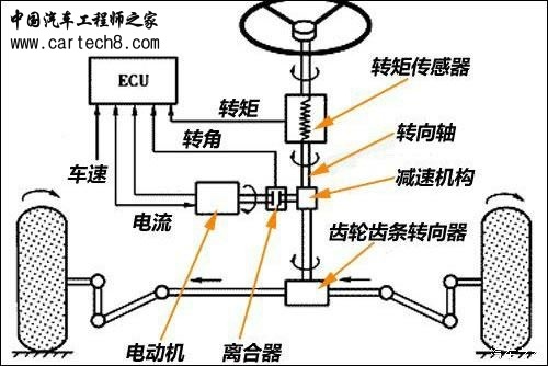

getimg.php?url=http%3A%2F%2Fwww1.autoimg.cn%2Fzx%2FBlog%2FContent%2F2015%2F3%2F30%2F2015033008475136279.jpg
  电动助力转向系统结构示意图

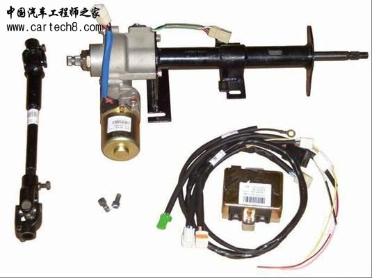

getimg.php?url=http%3A%2F%2Fwww1.autoimg.cn%2Fzx%2FBlog%2FContent%2F2015%2F3%2F30%2F2015033008475206484.jpg
  某自主车的电动助力转向总成,价格在1400上下
