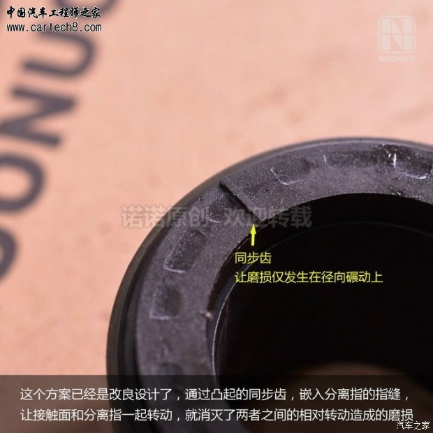

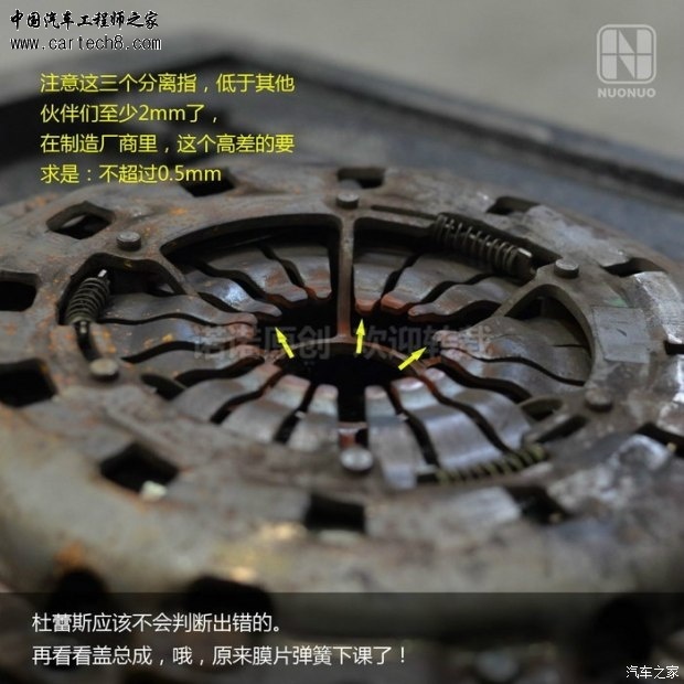

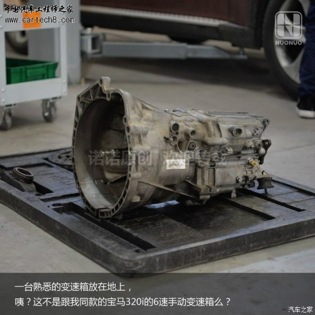

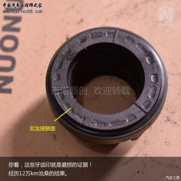

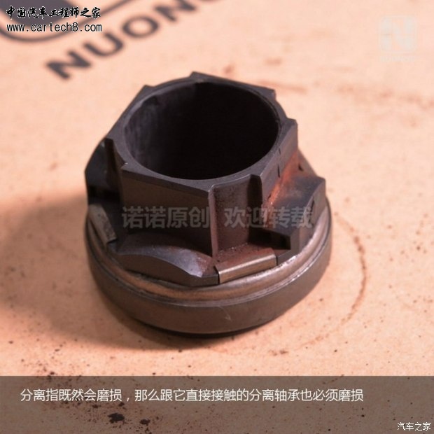

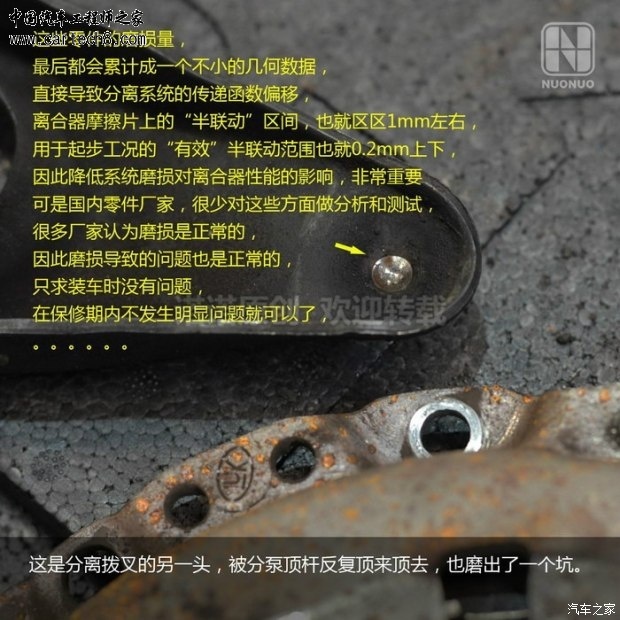

[结构原理] 手动挡粉丝必读-谈宝马离合器
发表于 28-6-2015 08:15:28 | 显示全部楼层 |阅读模式
getimg.php?url=http%3A%2F%2Fwww1.autoimg.cn%2Fzx%2FBlog%2FContent%2F2015%2F6%2F24%2F2015062410150848272.jpg
getimg.php?url=http%3A%2F%2Fwww0.autoimg.cn%2Fzx%2FBlog%2FContent%2F2015%2F6%2F24%2F2015062410151074472.jpg
getimg.php?url=http%3A%2F%2Fwww1.autoimg.cn%2Fzx%2FBlog%2FContent%2F2015%2F6%2F24%2F2015062410151236712.jpg
getimg.php?url=http%3A%2F%2Fwww1.autoimg.cn%2Fzx%2FBlog%2FContent%2F2015%2F6%2F24%2F2015062410151420314.jpg
getimg.php?url=http%3A%2F%2Fwww1.autoimg.cn%2Fzx%2FBlog%2FContent%2F2015%2F6%2F24%2F2015062410151606966.jpg
getimg.php?url=http%3A%2F%2Fwww1.autoimg.cn%2Fzx%2FBlog%2FContent%2F2015%2F6%2F24%2F2015062410151760398.jpg
getimg.php?url=http%3A%2F%2Fwww1.autoimg.cn%2Fzx%2FBlog%2FContent%2F2015%2F6%2F24%2F2015062410151911720.jpg
getimg.php?url=http%3A%2F%2Fwww0.autoimg.cn%2Fzx%2FBlog%2FContent%2F2015%2F6%2F24%2F2015062410152041531.jpg
getimg.php?url=http%3A%2F%2Fwww1.autoimg.cn%2Fzx%2FBlog%2FContent%2F2015%2F6%2F24%2F2015062410152249670.jpg
getimg.php?url=http%3A%2F%2Fwww1.autoimg.cn%2Fzx%2FBlog%2FContent%2F2015%2F6%2F24%2F2015062410152405009.jpg
getimg.php?url=http%3A%2F%2Fwww0.autoimg.cn%2Fzx%2FBlog%2FContent%2F2015%2F6%2F24%2F2015062410152575192.jpg
getimg.php?url=http%3A%2F%2Fwww1.autoimg.cn%2Fzx%2FBlog%2FContent%2F2015%2F6%2F24%2F2015062410152765051.jpg
getimg.php?url=http%3A%2F%2Fwww0.autoimg.cn%2Fzx%2FBlog%2FContent%2F2015%2F6%2F24%2F2015062410152898112.jpg
getimg.php?url=http%3A%2F%2Fwww1.autoimg.cn%2Fzx%2FBlog%2FContent%2F2015%2F6%2F24%2F2015062410153104528.jpg
getimg.php?url=http%3A%2F%2Fwww0.autoimg.cn%2Fzx%2FBlog%2FContent%2F2015%2F6%2F24%2F2015062410153200604.jpg
getimg.php?url=http%3A%2F%2Fwww1.autoimg.cn%2Fzx%2FBlog%2FContent%2F2015%2F6%2F24%2F2015062410153412763.jpg
getimg.php?url=http%3A%2F%2Fwww0.autoimg.cn%2Fzx%2FBlog%2FContent%2F2015%2F6%2F24%2F2015062410153550042.jpg
getimg.php?url=http%3A%2F%2Fwww0.autoimg.cn%2Fzx%2FBlog%2FContent%2F2015%2F6%2F24%2F2015062410153687472.jpg
getimg.php?url=http%3A%2F%2Fwww0.autoimg.cn%2Fzx%2FBlog%2FContent%2F2015%2F6%2F24%2F2015062410153915079.jpg
getimg.php?url=http%3A%2F%2Fwww1.autoimg.cn%2Fzx%2FBlog%2FContent%2F2015%2F6%2F24%2F2015062410154155029.jpg
getimg.php?url=http%3A%2F%2Fwww0.autoimg.cn%2Fzx%2FBlog%2FContent%2F2015%2F6%2F24%2F2015062410154401512.jpg
getimg.php?url=http%3A%2F%2Fwww0.autoimg.cn%2Fzx%2FBlog%2FContent%2F2015%2F6%2F24%2F2015062410154567770.jpg
getimg.php?url=http%3A%2F%2Fwww0.autoimg.cn%2Fzx%2FBlog%2FContent%2F2015%2F6%2F24%2F2015062410154693514.jpg
getimg.php?url=http%3A%2F%2Fwww0.autoimg.cn%2Fzx%2FBlog%2FContent%2F2015%2F6%2F24%2F2015062410154897599.jpg
getimg.php?url=http%3A%2F%2Fwww1.autoimg.cn%2Fzx%2FBlog%2FContent%2F2015%2F6%2F24%2F2015062410155021112.jpg
getimg.php?url=http%3A%2F%2Fwww0.autoimg.cn%2Fzx%2FBlog%2FContent%2F2015%2F6%2F24%2F2015062410155188634.jpg
getimg.php?url=http%3A%2F%2Fwww1.autoimg.cn%2Fzx%2FBlog%2FContent%2F2015%2F6%2F24%2F2015062410155368990.jpg
