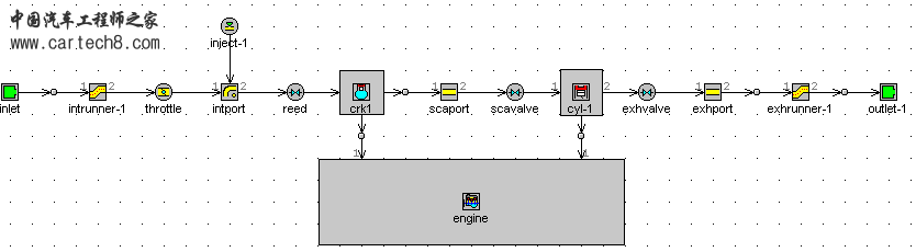

    本人GTpower新人,基础不是很好。。想搭建个气口式二冲程汽油机,搭建完后运行出现以下提示,
    *FAIL:The input flow coefficient data for a valve extends to a range such
          that the maximum CD entered results in a valve flow area greater than
          the geometric area of the adjacent component.
          The maximum CD for this connection is  2.31017
          based on constant (valve reference) area
          or  0.577542 based on curtain area at the last entered CD
          to avoid this physically impossible situation.
          Part:   scavalve
          Object: scavalve

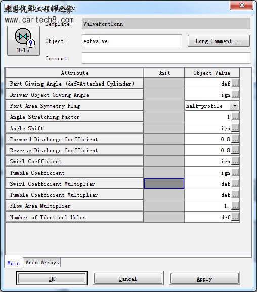

    把请问问题出在哪?我改过forward discharge coefficient,但是没用。。该修改哪里的参数呢?求各位大神指点~
