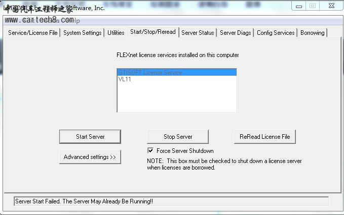

    我那个改好了, 但是我安装完成后出来这个对话框要怎么改啊,求指教大神
    Checkout Failed: Cannot connect to license server system.
    The license server manager (lmgrd) has not been started yet,
    the wrong port@host or license file is being used, or the
    port or hostname in the license file has been changed.
    Feature:       GTise
    Server name:   172.30.121.39
    License path:  27005@WIN7-20160303LC;
    FLEXnet Licensing error:-15,10.  System Error: 10061 "WinSock: Connection refused"
    For further information, refer to the FLEXnet Licensing documentation,
    available at "www.flexerasoftware.com".
    We will now launch the license troubleshooting wizard. This will provide more details about the licensing error as reported above.

    发表于 27-3-2016 12:27:06 | 显示全部楼层
    我的解决了, 我是先在lmtools里强制停止服务两次再打开的就好了,你也可以试一下
