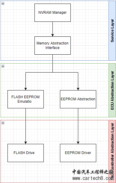

NvM模块我们知道,位于AutoSar的Memory Stack的服务层,Stack的结构图如下:
那么,AutoSar(ETAS)的代码是如何实现EEPROM的读写呢?以如下代码为引,调试下NvM读取时关键变量、状态机的跳转过程。

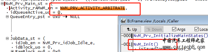

NVM_PRV_ACTIVITY_ARBITRATE
NvM活动仲裁:
在执行完函数 NvM_Prv_MainFunctionArbitrate() 后,可以看到
NvM_Prv_Main_St 结构体的变化如下:NvM_Prv_MainFunctionArbitrateNvM_Prv_MainFunctionArbitrate%3CmxGraphModel%3E%3Croot%3E%3CmxCell%20id%3D%220%22%2F%3E%3CmxCell%20id%3D%221%22%20parent%3D%220%22%2F%3E%3CmxCell%20id%3D%222%22%20value%3D%22%22%20style%3D%22shape%3Dimage%3BverticalLabelPosition%3Dbottom%3BlabelBackgroundColor%3Ddefault%3BverticalAlign%3Dtop%3Baspect%3Dfixed%3BimageAspect%3D0%3Bimage%3Ddata%3Aimage%2Fpng%2CiVBORw0KGgoAAAANSUhEUgAAAjIAAAH1CAYAAADsyRTIAAAgAElEQVR4nOy9fZgbZ3nv%2F53ECYnjOE4CzpvxC5GcZCuKDw5vowOxHUiRHGAPUPX80lK50I7wj0Okcl3Lr7nYC%2B9ScQW6hyIRoEg9CSsuaopOj9m2WU2bhtg%2BZVVM4pYXsUk8wlk7IUmTsFnbsWMndub3x8xIM6N507xIo93740uXV3pm7ueeZ56Zued5%2BzKTk5MiCIIgCIIgBhBGFEUKZAiCIAiCGEiWHTt2rN8%2BEARBEARBuOK8fjtAEARBEAThlvMA4Otf%2FzouuOCCfvsyUFCZdc9iLbN%2BHheV6eLKe1ChMuseKrPuMSuzZX3whRhwLrvsMlCXZHdcdtllrvcNqqyNfHKTl5P6oM4ryLozNTVlmjY8POxbPkGezzDWFT%2FoZZlVKhWk02nT7dXpg3g%2BflooAAD2jY21fsstLPhmP%2BjrddWqVa2%2FF3zw21Ugoxyk0QEGUQCDYjPMefuV52WXXQaGYSCKYqhvmmFEKTejvwF0fJ%2BcnMTw8DCmpqZ8fQgD7fOoR8mzWztW9UGfV1B1xyqIUdL9Lkc3BOlHN7ZXrVoFURRb58%2Fqfz8eNgCw3%2BT3Lcw4AGCfuMswfc7BcSm2941Ltsbl%2F43YtWtXa5v169c7tq33V4%2Fefyd%2Bd8NPCwXsGxvDlrEx3LJlC27Zt6%2Fto5zmNaC57LLLML4fGNsnHbW46xZfr1el3u3fvx9btmzBqlWrPNcv1y0yVjcv%2FY3YKVYPW7c2rQjCZhjz1j9I%2FMizl8GM34Gf%2Fg1LsWn2u5%2BoAxj9d%2FXfyjny8jZohlkQAwA7duxwVT%2FM6oNRXgzD%2BF7v7YIY9XZ%2B5qsct5OHpv7cd2Pf6XenKOWlnBu7%2F8MSBDphi1ze%2B8bHW2VvxLicXqlUus7DLOAKCiWA2bVvH%2FZBbomRgxmFW7ZsAcbGUJBbO9wENOogZmzLLRjbtx8MM47JSftgzwn6IGZsbAxjqlYlt3jqWgriYaZ%2FO6W3fm9YPbS6taOnl8GMul74kZ9ZYOd3wGeXtxG9DGImJydbf%2B%2FYsaP1vx%2FBjDovxZ7SpOw2DyOcBjHq7f0%2Br1YPTLcYtYxYpSutC3Yo52Cf6m3eji3yA9OvlpmWXV3Lhl3LjFOcBjFuMWqRCSK4UQcw6taXXQDGx8awD8AYABEAI%2F8N%2Bf8xDy0dShDTtjZptbkjlCAGgCaIUXxU6qUbnz2PkQnqYaYPaIjusXpoebGjptfdTIPerWX0QFJTqVQCC2L06AMJO9%2BcYHd%2B%2FMhDTbdBjHo%2FP4IZ5f5k1SKj39ZLXlZl57R1QW3HSTCjBEd%2BXXdbGAZjY2OtlhMn2zvNW7ENOOtaYhjGcUCn9ttJ0NKN36Y2xsYwBmB8yxZs0bVc7FL9rw5i%2FEDdIuOvZVUeuiBGCcbddDX5Mtg3yIeLPqBx0wy4VLAadOn27ddJi47y8O0ViymYUf8dZEuMHX613AHa86MEz0Efl1H9U4IVJdhRtnEb%2FFgRRItMULg9z36MlVHGr4yNjWGfKiAwa4nZIvvq5B6jtq08FO1aZQBgbm4OmzZt6spvszEyyjEo2%2Ftxb1SOgJGDmiA5duwYdt1yGYB2i4xf3UpmqLub3OLbrCW3fbXd2Aeoy8kM5UHkZ3eIWYuO0gWh%2FNaPvvNBDGbU14f%2Bb3VLjHJB33LLLb77oA8ugGDHUOnt%2BNkao6AOVtTf9f8DncGNV5yMkQGkQKfbe6S620jJS52nPt1p15LbVjE%2FrrexsTHsE8VWgOKEfaKIOQcvsGrbToIYJeBx8nKs99uuRUbZ3onfYePYsWPIbQJyreDOOshzg1IH9UGM2%2FEyvk6%2FDjqYUfIAnF9UVjOs7PYblIek0du00fgELygPv3Q63Qpk%2BhXEKAxaMGM0UBPQtsSM75f6pwEgqEtJfc6CCGIU1OcnyHz8Dk7cEFSLjFnwa%2FSb066lfrXIqH3bpzsWo8Bgnyo4TKfTlte52raTriWF8fHx1vgfJ7YVv9UtMnrfu%2FE7CNy22ij3n5adfe0vk%2BvnPF2v6vExCsp3JYjZsmUL9u3bZ3s%2BjPB9Zd9edf10k8%2F4%2BLimWfuyyy7TVPIdO3ZoboLKTdevG%2BNll12m%2BXSbbmdbfWNKp9O%2BdhOoUVfkfgcxCoPe1ajvTtp1ixTA9GJoWJDBhQLDMD3Jx%2BmYF78DHnVriP5jtm03GA3wtfruBLcvm15fUnfs2CGNMWEYbGEYzQMfkAIAdZrSqgHYX%2Bdq20ogs2vXrtYHgGaGjNIas2vXLszNzXXt9z5xV%2FvjwW%2B3MAD0NWwM2sG%2BXlDGyPiBPojZv3%2B%2F5gNog5i%2BDPZVMzk5qXljDwJ9s7hT1E2N46r%2BTqVi79ixo6MJ1y8qlYppmezYscN1V43Z1FY1bgf4WhGWICYsfrhFHcSou5PUfcVBdC%2F1AnW9U7%2BR9vucBdVqE9SsJf13q1lMTruW%2BjlGRj1%2BZUyeQqxGk%2BbRtt6Gn7b99LtbtoyNQZRbLfbv24d9Po2dUcbHKK3CrTEyHlpjjIIYoxYXL0EM4GMgE%2FQNSn1jdJuP%2Fi1p%2Ffr1mJycbAUSQbRiAJK%2F6nzM6LYM7aJ9t0GfFceOHQtF8NDvB6JX1GNi9N1JW1RvQkG3zKhvMn42geub1IMIqBXMBvH2osvJboyMOsBxO0bGbXoQ%2B3mtI%2Brj1wcbVmlB2e5mXFFQfjtlDGgthKegLIq3f9%2B%2B1gwnX%2FLSzFpyh1kQY1Q%2BXoIYwKdAJsiHin6AqV83RPVqjk6CDK%2FYBTNuytDIpr58%2FDovyrofVst%2B96oveJCDGPVKourupF2q51svVxzwq8tHf53qx8c4XQ7eDUYBjN3ffkOzlpxhFPCpB%2Bj6bVsJ2ozSulkQz9g3qTPHq99OUa8dow5o%2FGiV0Q9p0Acx3Y41NQtijMbATE5Oeq5XnsfIBPVQmZycbNm2eni6Qb8ktd%2F2zVACDz1eytDI5vDwcOvjBfUMF0B6SDEMY%2Fjp1ViVQQ5iRFHUBDH6fmKjvuNBQDknw8PDpjckpZ74HUx4uW78wGyMjNW2TtGvrms1iwlwHkz1a4zM5OSk5m1cP2bFLC0o207Ly8z2PnGXZ7%2FtGIN2LMwu%2BbNvbAzjW7aA2bJFo7ek3q9bP8b3ozXYVz1GZsfcejDj%2B13f4%2FVBzMLCgubjx7XoqUXG74eK0dTQIJibm0OhUEAulwtsYKwZ%2BlYUP8rQaddV2Gx3g5%2F1Qh%2Bg2f3uF2bdSUBnl5LyW9gx6mpU6ksvZjEC3Q%2FgDeLeEkSLjN0sJbdlq77fOelWUe%2Fn5c05nU5jbm5OE2Aoi%2BJt2bVL8%2FDtZsE8M9uA8XhIdRDjpGvJyPbYGIAxY9vd%2BG1HbmEBPy0UMK4MYJZ%2FN1sET%2FnueSyTx24loL3YoNeBvE5wHciYPYC9Pgz8tnns2DHLihr0w8sIdSuKXzdVs9aesNt2QhDjcszsBRlAW3UnAb0PXIKq%2B%2Foy7MU15jSY8fv8Kt0TZi1o6sHaXpfFN2L%2F%2Fv1dDwhfWFjA1NRUV9Nc%2FXpp3bJrF%2FaZlIFVmhvbepkCfdmPj49jy65djtZ66bCtc9OL33ZsyuWwKZczDGgUvAYwx44dw%2Fo57fUz6TzG7WBhYQGrVq3qSRADuAxk7B4sQTwMvNi027cfXRVhK6N%2B2l4KHDt2rK%2FrnJgR9Ng2pU%2B9F%2FXHLpjxu%2FV4amoK69evt2xyV0%2FttdtWb9spdtOHjVDKwqn6tV8toXMBXQNGtu3Ke%2F369Y6CmCD97gZ1QMMoLUDyx48gwe9rVAlm5ubmAg1iAJ%2BnXxMEYc5SCgb7day9zHfQXxwWFhZw7NgxR%2F%2F7xaCWWZiu3U25HBZyuX674YigAxgFZmFhYQB64gmCIAiCIDrxfWVfgiAIgiCIXkGBDEEQBEEQAwsFMgRBEARBDCwUyBAEQRAEMbBQIEMQBEEQxMCyLIxrWxAEQRAEQThh2YEDB%2FrtA0EQBEEQhCuWAcC2bds0P37nO9%2FpizMEQRAEQRDdoFnZ9zvf%2BQ4YhsG2W9%2BLd2%2F5HaxefVW%2F%2FCIIgiAIgrClFch85zvfweWXX4FPZT%2BLU7gQJ84BJ555oZ%2B%2BEQRBEARBWNIKZBiGkYIY5nX99IcgCIIgCMIxywCpNeZd73o3XmZeB6bfHhEEQRAEQTik1SJzW%2FKDOClSGEMQBEEQxODQCmTeuOY6PPbU8%2F30hSAIgiAIois0s5aoPYYgCIIgiEFCG8gwFMoQBEEQBDE4UCBDEARBEMTAQqKRBEEQBEEMLF21yLCxta4zqjeOut6XIAiCIAjCiK67lvab%2FL6FGQcA7BN3GabPHdyLjTdvM0wjCIIgCIJwA3UtEQRBEAQxsHge7Ku0xOi%2FG7XM0GBiM57FkR8JuPit78bq5f32hSAIgiAGB1eBzBaGwdjYGLbsMu5GMtpeFEUcePTXHWnHHpvGnHodvktuwI1vjcBK8enYY9OYw2a85carNb%2BfefL%2F4rHnr7Xd3woj20Z2%2FcirDSOt4cMwoFiPIAiCIJzTdSCzb1xqcRkbG8O%2BXbtaLS9mLTFbZJuVSgU3veN9hjYvWr8FN65dAQBYePR%2BPPbYCmy66RpTH1a94Vpg9hkcu%2BkarGr9%2BhIWnj%2BBVeuiuMhDMLDqDdcCR17CGYbBRSq7OPk0Fl6O4mq5xeT0yRO46A3X4CLLMnsJzx7ch9Prbsf61zvInAIZgiAIgugKTSBznoOn6NjYGPaJYitAccI%2BUcRcpWJoX%2FlJSVt%2ByUrgFGPtyxuuxeV4BMde2Iwr3iD%2FdupZLJy8Fte8gfE28OeSlbjo5NM49vJGLF8OAC%2FhzMlrcfnqp3HmFIPzLgGAEzhzaiUuX38pzrMpBgZSe4v1doz0j7HbjiAIgiAINdoWGZunaKVSaf29TxQ1aUZjYpTWGwBIp9M4KDzbsQ0DqSVIyvsEFp4%2Fjss3XAvmPAAnD2H2J0%2Fj8rdvwTVQ%2FX3Jtbh8NXD4hWfxpquklpuXX3gap1ffgCuUYzh5CLM%2FeQwvy%2FlcHvsg3vQGADiBZ36yFy9veBvQeBgvXnIjht6%2BERcrDq24Bldc8hhefpkBswLA80%2FjxdXXYeiSlzCr5HfyWSycXIFrVshdQoZ5PYPDex%2FGiwAw%2B4%2BqfFS%2FA7h4w1YMrZd8Zl44iH9%2F4mkpYfXbsPm3zFulCIIgCILosmtpx44d0tgYeTv9OJl94%2BMYGxtrpSmtN4AUBL05%2Fv4OmwwDvPzEXhx8Qv7hkhvxW6uVMSPtjRjVDgwDXLHhRjxz4GksxK7F5TiBhefkAIgBgBN4%2Bgjwpm0fkgKU5x7BI42DWNh2My6XLb3YeBrXb%2FsQru%2FwaCUuX70STz%2F%2FLJjV1%2BDF55%2FG5avfhuWXnMDFjRM4zVyLi0%2BdwMtXrcEVDGOZ1%2FXbtuHpAw%2Fh5Q0fwvWrAeAZ%2FOqhh3F6wzbcvOFSVZ4nARzH06duxM3b3gacfBy%2FPPA4ntlwLa69xPKUEARBEMSSpusxMmNjYxBFEeNK0CIHLgqaNB1m9i9%2B062IKQ%2F25x%2FGww89gutvfRuuWHEjYrfeKG%2Bl%2FhvAiutwxYof4sUX3oYrlj%2BDF09eh2uvUgKelbguthIvP%2FEQHjl8XN7hOjkgkgOh334brjA53OVXXScHLZfi9MmVWL6BAXPJdbiCeRgLp27E6ed%2FjYsvuVE%2BHvu8mPPksS%2FP%2FxovrrgJsTet7BDoZLAS1ymB2IrrcMWKp2nMDEEQBEHY0HUgI6q6lJRWFydpZvbPk%2FqW2mmrr8MVeAxnTjFgLFsjVuLKq1bi5889jTWX%2FBovX30jrlRsnHwMv%2Fi3R4Hr34u3v%2FdS%2BfsJnKcEF5I35kHCiktx8UtP48yppzGP6xBdwYDBSixfcRy%2FOfUSmJMrceWbVkr7d5UXIx8zY6g0zjDt7WgWE0EQBEHY03UgMz4%2B3vGbMvjXKM2p%2FVbac09jHitx5QoGzMnH8PP6r3Eleyuug%2BpvOcC5%2BKo1uLj%2BOIQVDNb89pr2Q%2F%2FUCby8YghvkVs%2BTj%2F3NF7GpZouKkYdJJzU216DK6%2F%2BCeafWANcdSMulje84qo1EP7zMTBYgzXK%2BJhu8rrqOlz58wP49fM3IbIaAH6NXx%2B%2BFNe9SQ55NIGL%2FjtBEARBEHq6CmQmJydb42QAbauL8rdRmpV9BsDLv3oQB36l%2FLIGG297B66QE1uDgaH6WzGz4jq8fsUsnsSQFPgoJq66CW%2F81b%2FgZ%2F8yCwBYfvUaLG%2FZMWiRYTptX3nVGgg%2FewpXvuUd7e2uWoMrf%2FZj%2FObqdyKq%2FGiZ12W48urL8LOf7cFvVgzhLexNiMZP4Ocze3BAdawMXmqVD7XIEARBEIRzmJ07d4pPPfUU%2Fte3d%2BM%2FX3rFcuM3r7tCM%2F7FbrCvOm2uUsFbt3wggEMgCIIgCGKp0nXX0pZdu7DPZEVfqzSn9gmCIAiCIJzSVSDzyycXMPfQ37vOjAIZgiAIgiD8RBvIGM6l0fK2bcOBOUMQBEEQBNENntWvCYIgCIIg%2BoUmkHHQIEMQBEEQBBEauu5aIgiCIAiCCAvLAO2KvEYceHBPT5whCIIgCILohmX2m0gcOHAgSD8IgiAIgiC6xnEgAwB33313UH4QBEEQBEF0zXn9doAgCIIgCMItXbXIKPzFX%2FyF334QBOEzn%2F3sZ%2FvtAkEQROC4CmQA4Itf%2FKKffhAE4SOf%2B9znHG%2F7wx%2F%2BMEBPjLn11lsdbTc1NYXhYXeLcK760jOu9lvsLPzZNY637UfdGER6UZ%2FDfJ32G9eBDEEQi4ebb765Z3k98sgjPcuL8E4v68Yg0sv6TNepMRTIEATRNWvXrm39ffTo0T56Ys%2BRncv77UIoWPdXp%2FrtAkEEAg32JQiiK9auXYvx%2FQAzvh%2FM%2BH5NULOYWLduHdatW9dvNwjClrVr19peh062GVQokCEIwjFKEDO2bz%2FGttwCAGCYcezdu7fPnhHE0mTt2rVgGAYMw7SCFX3A4mSbQYYCGYIgumZsyy0Y27df%2BdZXX%2FxG3xIT3paZvbhr3Ydx31y%2F%2FSDChDpgAdpBjNU2gw4FMgRBdI26RWbQA5l169Z1dUM32n7vXeuw7q69nb99%2BD6o44y5%2Bz7c8VsniydA8aNs7%2FtwZ9kC6rJcPOXlhqNHjxrKDCmBijqIEUWxI6hZDFAgQxCEY44ePYpdt2hbZCYn12Pr1q199swdSpeY%2BuZ%2B5MgRHDlyxPC70fYAsPW2O4DHn1AFKHvxwO7N2Iz78ZDqAfuEcBCbb9%2BG9b4fSfgwK6tut%2F%2F4p%2B8Adj8AbSgzh4fuV8pyK%2B4%2BsgcfXwqFaoISzDAMowlq1N%2F1QYwoiqEfqO8UmrVEEAPAT37yE7z97W%2FvOi0Ijh49ij%2FaAPzRhg3yLxsst%2FebZXsfxPLPfQbMyeOAyAAwFr1t%2Fbrb3FYaQHrtKunLu9%2Bi3d%2Fgd8vtAeDdxdb3v1kL4HkAH1PvvwrpH30I%2BLa5T619P%2FYW64262K7lH2BZHno%2BbPQjA7x20XIc%2F9gf4%2FjHPmG6744dO3DkyBHH3XKm22%2B9DXdgBx7Yezda8fLcQ7j%2F4B349J71kFqw7kF0vxLM7MVd63a0DvOOySO4e%2Bsc7vvwLbj%2F9v3YI0c8e%2B9ah3ui7e9z930YtwifxpG7BzMo1wczStCi%2Fw4sriAGoBYZggg9x48fxz333IM9ezpV6Pfs2YN77rkHx48fD9yPtWvX4ttPtD%2Frvv1E69Orwb7L9j6IS3J%2FAual4%2FKT2TiIIQJEBM57%2BRRWle%2FBqm8VDDdR1wd165YZ1ttvxW13ALsfaG8z99D9OHjHbegMOeZw34d34PFd%2B6WWtP278PiOu7AX67Ht9s04KDyh5IgHdm8GhIdarWhPCAdxx22DGcQoWLXMKCy2IAagQIYgQs%2FKlSvxjW98Az%2F4wQ80wcyePXvwgx%2F8AN%2F4xjewcuXKnvqkHSPTOy75szsBg%2FEARD8QsXJ3xTBF3bqybt26jkB37969mkHUO3bswOTkpGlO2q47qVvJMOhQWmqUfqb123D75t14YC%2BwfsMNbRt7H8DuOz6Nv4wKctefFNhEe9u46DvqMTH6YAZYnEEMQF1LBDEQKMHMpz71qdZvvQ5ipPEx8vRr9RiZ9XO9GyPzcntRtzOf%2BH9x5vf%2FCOLr32C4qSJRYLYgnvIQVW72RmM59GmWrQt778K6e6LYv2cDSusewG1H7sZWzOG%2BD38G%2BMs92FBSd2VI3R%2BP71J%2FV7pHdF0le%2B%2FCuh3A5JG7dS0QRl0q6u%2B645UXxOtWokC%2FmuxFP30Eqz8tdymJr5nuu27duq7K1rIObb0Nd%2By4Bw%2FNfRwfx0O4H7vwl0abPyHgIHZjxzpt%2F9kdLRsP4AkATzywG3fcdjfW4wHc%2F9AcPr7tCTy%2B%2BXZkBnicjZOBvUpws9iCGWqRIYgBQd0y06%2BWGIV%2BtchAdV8%2B8%2FFPmgYxTlG%2FsRq9vZqlGbL1Ntxx8H48tPcJPN7q9liPDTcchPCE9MZ%2F%2Bzb5Sbn3AeyGquXAig1RbLbfqmec3nQz2ifCfCCvr2WLrcjsAu5%2FaA5zD90PWA6YvgOT8gBt5SMNe9mK2%2B7YjQf27sUDu%2B%2FAbVsBbL0NN4yXsPcJwcZmuLELYvTdTItl2rUCBTIEMUAowUyvgxj9AlradWR6uGqo6pknXhrM8TsZ02HMVtx2x0Hcf8%2F9UPdRbL3tDuy%2B5x48vvl2KHGMFJw8jieUARp7H9CNwT2I1nAOuXtkR2sK8hzuu8tuCnfQiLr%2FneG%2BbIH1224H7i%2BhdD%2FaAaGerRns2rwb96jmYs%2Fdd1dravaG6GY8fs892N0KNKXg5p57HscNGwYzjHESxBiNmVlMwQwFMgQxYKxcubIvLTHj%2B6UPoG2R2TG3Hsz4flQqxuMlwsrk5KTmhs8wTGuchlWaFRuim3HwoO5BuyGKzQcP4uANG9pv%2FOs%2Fjr%2FcBYzfIo0TWfeA3P0BQGp92IzdO9Zh3TppoOrH90zijt075HElt2AcG0LdehBE2WL9NtyO3dh9w6ctplpLZXXD%2BC2tMTi33B9tBZDrt90OHNSOr9l62x04ePAGDPg4XwDmU6wXezBDY2QIgugafYvMILJ161bNQ3VycrI1TsMqzYr1H9%2BDIx%2Fv%2BBF7On402PZuKztbcfeRI%2BpNpF2ObNVtE46ncRBlKwUpR9BZkvrjNi4ryYTBudh6Nzw0FPUdswXx1GNh1NssxkXxKJAhCMKWo0ePYv2cdubJZJibBByydetW0%2B4OqzTCHirb3qEevKsELPoBvU62GVQokCEIwhGDunovQSwlnAQniyWAUaBAhiCIRY0y7ZggiMUJBTIEQeCRRx7ptwtESDGqG2tt0olgoLI2xnUg87nPfc5PPwiC6BO33nprv10wZXh42PW%2B3Sz8RhjjpG6Euf6EDS%2F1mcrZHFeBzGc%2F%2B1m%2F%2FSAIgiAIgugaWkeGIAiCIIiBpasWmbvuuisoPwiCIGz5pupvuh%2F1DzoPRJjoKpD55je%2Fab8RESBNFONR5OrKdxYFYQbZiF%2F2eWSYJFATUUr4ZLJZRDw6i1GxBL9MLh2a4DNpJMsx1Kj8JNZ9r%2FUn3Y%2F6CJ0HIkRQ19JAEUF2RoQoihCFAth%2Bu0MECI9MPIo8RiHoghg%2BEwfDMGAYBvEM371lj%2FsHbT%2B8%2FvHIyPtpPjobdvbdpzvL3%2FoQioir9o1neDQt8mfiGfD6DTwyuOWPUJSfVxZj%2BXcZyEgHEi82db9lYF8cciEYXZiOC9OgIOMZFHtWUTrzj2eKHRU5vPb9oolinAETD6NviwM%2Bk0Q5VsNMKQF1g1uzGEeykYIgihBFAalGUnc9WuN1%2F6Dth9u%2FBEqi%2FCIh719gWXDD7TDTzr63dPv80eRRVD9ImTgy6idpdDsqgvIyVEOsnETaIv9arIzkhH%2FB5GCXPzyWn3Eg0LZvl%2B6dRVv%2BO3fuFG%2B%2F%2FXbxP184IT761HHDz%2BTkpLhz505RFGsiB4gAJ9ZEhZrIab6bYbBvjRPBsiLL2e%2BtttHeXBALHESwBVFwaMEbuvwF6Ttb8Cv3LuwLBZEFK%2FqWtVH%2BZggFkWVZZ%2FkLBZF1VD%2BIFqZlZnB%2BapzuerTC6%2F5B23ew%2F9pV7U%2FP%2FdOb43T3Ljv7XtOd5Q%2Bu1r4fCoJYE8wuUkEssNr7i1BgRaht1jjtdwVX52GRlX%2FX5Wd3f3V4%2F3XN4i1%2Fl11LZeSNojg%2BY9C6Ir29Sz9z4LgypuRNmoca4FIpdy4AACLIDnNAfRaC5AAyDIMM31S9lcTbLTa2%2FnWbfRRDLFCfFVTmisjETZoW%2BQyYeBF8MS771ZSb0eLGrUqRBIa5bp1qat%2FIDJo2m8WMrnnOrGWlCT7T2fLSnK4CqVGk2Dqq0%2Fo9tWWfmVan2ZwfR4dnUb62x6fKP27Qoud3%2FXBJc7qKOjfcOSameQgNsBiKqn6LDoFFA4eagFGLabMYb58%2F2%2F29Or7I%2FdMaQzHfQGpE3RpiY99ruk3%2BfCaJMluAoG7Fi0SQiBgPomvy06jWOYyqBtlFNsaAclJqxWnyyOQbKIz4NDprUZV%2FH8rPK4u4%2FF0EMhxqNQ71XLrzAZQYBlfOa39vSpkprU%2FDwxzKUzyAJqarMQxv794DO8r5NGaHK3LTV3f%2BdUOTn0Cuzuoq6kYMVyrtpjeUkVc%2F7Os5TG2sQCgAuXQah0ZmUOOMAgKgyReRL7NIbXc6mlceDIxRbdNmtN311yzGEc01kKoJrSbCysh2dObQRDGeRh41iDNZVTqPiVwMo9kEtqdY1KvTmkrOZ6LItZoGKxieraKus2x6fhxhXb5Ojq%2Bcn8DGSrt8cmn5QvVYP5rFeEezsJvmYWG2DlZzNbcSUEcMG9UHE9mIGOqQYukESkIByEWlwKtZRDoHFCry%2BbPd3yOL3T81%2FASqqYp2oL2dfa%2Fplvk3cagBsCmja1m3a0aqk9FkFSlBN4g8UYJQYFFORsFE88Coj5MJFkn59638vLKIy99di0xiBAW2jlxH32kCIwVoHsrN6SpQGGmf7MQwuPIU%2BOY0qjGDt85uaPLIJMtg1fYBsKkKSmwXQKwAACAASURBVIkIpMGx6orkwD8HlJNKQTY6Zw1FEqo3oAg2xnQtNmwBIwk5PTZqWMnb9quI1SrOL4TmNKpyYBWR80%2BMFMBCaQVrYrpaB1uoIJtoG410vLFJQUw1VcGMfvoSP4Wy3FoQ2Z4CW8%2BhXQ14TJUBbjSryj%2FVMSjZ%2FPw4wLJ8nR0fN1qClCyXT70KqUp4qx%2BR7Iyq%2F1j7menV3SySRaXAopyMIy7dhcJzIwUWiX9NFPPQvIn3FqP8BczWgdhGe58SJalOCrUUqlFdayOfQTQXQ00QIQopNJK6MTZBMwDl77X8lPu71CLc2dphlx4oA1r%2BLruWIshWCmD1b6%2BQHm7ITcgtADwmctC1KCQwzJUxNVFFzE0zCFQnOpoHCkLHQ8LqYrb3zx6upswaMnpT1HbtJMtdmW7bF0UIQgpIRp0PhjaNaFsbOLrZNfJp5JBCxaCi8lPl9uCuyHakWMgtbDBuGjTAyc3WHKvydX4zN8OP%2BhEYRs2sBmUeyY6CY%2Buo65q9ne5P%2Fpn4p8BPGL%2BE2dn3mm6Zv9TN3eiiDy6SyGKUU12%2FaKKYL4OryYF%2BJIuZWgzl5ISDyRwOWCzlr%2FjpsvyU%2B7soirrWbmfprlnE5e9%2B%2BnUki1Gujlw6j0bH73ILAD%2BFBtfZ6pAY5lAux1x15wDqEz2DUrdRoQP%2FnNqRIlf1jC19146IWtdjXFRZRLIo1TigPOXsRmJaEVobOLrZxUZnUIvlEO14G5BaXNpvDPKaNk7984xd%2BXZ%2FM%2B8I%2FjzUD7%2B6lqJDrLYVT8Gom0GYRZ1NQR1rNYt5lMGBQxlJdRDscH%2FXLHb%2FpNTOsQFO7XtNt8xfbp3UdfV2h%2FQioMHPMUqLovytCLj8vLKYy7%2F7WUv6GUv6WUzySGO2IBY49awWk9lNQsHDrKVu0638c5O%2FNGpaPyq9NYpdqGnT5XwFUTu6vcYp%2B3T6LxRY41HbhrOW2v4I8vcapz0%2Fkj1W5GqqkfaCIG%2Bvzl%2FeVz0jzHAGg3YfTf5CTeRYWI9K7wqb8nV4fOry0e%2FfOk5X9cMnLGZ6CQVWdU46Z01oRvkLBZE1qk9W%2B6t%2BdzObIXD%2FVLNl%2BuGfNGPPfJaknX2v6db5y%2FWbLYjt6i%2BIgnrWUutaMD4%2B7TUviDWNP22bbmePDX75eyk%2Fv2Yt9e%2F6DGv5ewxkRJPpUXJBaw44RIGMoX8u89ef7BonsoAIQGS5glirSengao4DGag%2FLGf8MDWdfi2IBY7V7F8T9Lu2fQSgqpgmgZqcXuOMy7bGqYIBoSAHL0re6oeyD9MLrcrX6fEVChobncXrtn74h6ZMO9La51cbhDgLhM33b%2B3l%2BkYZuH8eAxmv%2FgkF1na5Bbvy9ZJum79Q017%2FYHUPCk6TxhkFser8Ta4PL9PgB7v8vZSfwf0d6Ah0zNNVefTp%2Bgxr%2BTM7d%2B4Un3zySdw7%2BT3MnxYNW20OPLgHBw4cCHgpaml5fPMhJVzAy7T3O%2F%2BlTi%2FKPwAJhsDgkYkn0YjVUNEtiteb7DNg8kMQ%2FOyj94N1l7f%2BZNaMhc%2B%2FpYLqPODIi%2F3zY6kS1uuzT3SltRQs0qqBpSWb%2F1KHyl9LAqUZAXwmjSgz1eMgWuoHL4yWQn2TLIzSTbw%2FhGHAx1JmMK7PXhKiQIYgCC0RJEozEHse3UnT4kMLA0AEsqFvVVusyI9P%2BTwQvSbk12cfINFIX1GtGOtm1VpblJVp%2FbTZJ%2FhMAOVjh9zqQw9An1BWpjbTWrNId3r%2Bm0XE9fsrD8%2BnjnbkR9cfIHVLBrgWyZkz0v8UxPgM1V%2B3UIuMr0jq1FlAugFHq%2F12iCACoj2GRxCNxvDYpbvk%2FPOBc%2Bekv%2BOboH%2BaZrEK2bXKt1ng1svhJ6W1q4BP%2BmszCEpYhZJSDk%2BNAevGfLTOWCc3eWTSSZTlqcgs19txXnwmjqScOcvVOhf1DC30%2FHALqV93RdjVqY39C5uMPAAgUYIoulm%2Be%2FG%2BVTgjHMdvps7tNN3d%2Befxr8deVn2nJoH%2BoCr3t8d1aTwy0SQaqVpLJqUy7Mdqhs4IWj3dG4P5%2FOjOv%2F7cn1x1LdVzHlZ6VC%2Bexk%2BhzLIdS9jb0V4QT0BBrZXTI1r5CzXEyjmNjHsYUJfPKHIarSWC8EyziHyZQ83sTdcu3QPfnT%2BFh2%2F%2BqOoXm9YBIiAY%2FOr6dwD%2F%2B37Nr81iHmW2gEq2LZMSSUR61BrDYyJX10ikZEc5b8%2BrABiY50dI%2FTOC1K89qV%2BHU51a5SASpRo43fnS2Nfn3yzq%2Btddqksbqlvr%2B4D1AZa1OrUkFiZN0VbrkWjPnVX5OlDfdnD8lnhS57bO39nxB4%2BpOrdtut35l7cxVU%2BX%2BF9%2F%2FNfSlN8jL4J%2F%2F4uIf%2Bbh1vfW54djiB8dQvGHut%2BPPIzi%2B4fAHF2QPmtS4HXbND%2BTQlxJP7qA%2BPvH0DzyInBkNzJHF5D5VtsW%2F%2F4FMGvG0DyyG5mjKWTe305vfmYImc%2BMIf7%2B3eb21fl%2FKwVmzRj4zwyBOTqE4g8fBv9%2B5W%2Btj%2Fz7F3TH%2FTCKa9o%2Baz66%2FM0%2F%2BuOTjqFz%2F93IHH0RfzHyTx3nbrpadyRcGQhBq6er7h%2B86h4Tz%2FAO7386wv780PnHZ4xXKG8W42AyvOP7k9fnjxGkfu1J%2FTqM6tR6pMqoLHkv2QdGBVnPKdVAMq0KRKTEVt5CZQRRzfLVTtSlzdStpT5gURQhWmg3mKlTS2JhNXDQ6pG0X%2Fzty9faP%2Fvjt8eLOrd1%2FvbHb03g6ty26fbn34l6eut4Qnj92d3frK8%2FAPUcpjZWIBSAXDqNQyMzqHF1jZCpMUrZdtYPsWdjRBStM6H9MOqi699z%2FQxaPV2mnEwjPyTXIaGAWDkJtX6y%2Bf1FSxjrr5V%2FiWGj1i25FWw44ej%2B5PX5YwapX3tSvw6hOrW1A7L9ESjmJQVrpUVL0ioq56fBN5utvCMd%2B1v750ndGlbq1HaHZ1e%2Bdv7ZHb8DPKlz%2B5C%2FlWthUOe2xJl6eqivP8v7m931B4AtYERJjLnUgesz5fwUhpUXkVQDOYdd2%2BGvnxJsoYIZpesssh1Dugpqd%2F8Ldf218i8xggKrb92XuhKNpJcMDsDj88ccUr92q34dUnVqM6Q3ZMl%2BPRdtv%2B1Ec6i3ml7lt7rKRkylo2CYuKrZ1Ll%2F3tStPWBbvhLm%2FtkdvxO8qHP7kf8A41DpOtzXn9X9ze76G3SkBxGbGmm%2FiGRHwfXq%2BIJWT5fxev8Ld%2F218k8%2F5kgKTDjHC1N6ff6YQ%2BrXbtWvEUZ1aiOkt1ypcss3moKge%2BPRvTVEEijNiBCFFGLlpGqwlwt1aa8YXbxm2JavQ0yP3w6f1Lld52%2FjXdDq3A7T%2FSKs15%2F5%2Fc3h9RcihA45ZyukFki3eK6fQaun%2B0xY66%2Blf%2BpWGX4COThtjWn75%2F75Y46nBfESpRq4er2jDzsxzKGcL6I4ZSL3nShB7KNuka1%2FXdA81MVjMrIdKblLTjo1TfATOdShjNGJYHuKRT2XRkY1wqnZbHZUuERJsK%2BMTR7FeFLV9Ne2XzSy3%2BTB8%2Bq8NgJQR%2FjO%2FfNCeapdPsV8GdAMHLW4WG3L1wbb47dDeuNgh6LSG0qTh7Z62JSfo%2FzdB5N%2BNd1HtqfAWtx87dItDGvPX5NHJp0zHSMDhPT6M72%2F2Vx%2FfUddt5rgi3HkG93NKZXGUbTHT0pdD84CCe%2F1M4GRAotyvqi5f3QOPlYGnfd%2FNmco66%2Blf%2B1WmUy%2BbNAaY3V%2F8vr8Mcfjyr4JKWLr%2BHkEBeSQa4QzEvbqn3pEdrQaQ0FwGpRFkJ0RUEAeUYYBw0SRbHCoqfaPZGcgFGJoJNvNb%2Bm0wdQNRJAoCSigszKqu96qsZpGWEyxX9XYn4AgG5jKp2Xf2l136m5U5%2F65hxs6hLRcPtVYAYKmH1e6kKBqnmy%2FrdmXrx12x2%2BNfD3IvsUnDmHjaAFsOdlqnrUrP%2Fv8rY6%2FR8itmkmzJnG7dHPDyFYK4BpJqQzSUxiuFEzHyIT1%2BrP0wOb6s6a9zkeyrGqi923amrpupTGFCiqqSaXtFhPdzBT18SdK0vFF2%2Ben1kNhw0h2BrVYtXV%2Bq6nOoQf9Juz119Y%2FuVWmbNgaY31%2F8vr8MWXnzp3i7bffLv7nCyfER586bviZnJwUd%2B7c2SG37S8mEuatjzvJ8sHJnzCSkQ8PVD%2B01ESOhchyNVFwlU70Fqq%2FGmqcCLZAddMV%2FbhPW9ffEEkU9Fv9uN%2F5E%2BGG6ocWO3Xufqp3E51Q%2FW1D6tFeUGYqCT29oK3rb4gCGYIgBgs7de5%2BqXcThBWkHu0GPiPPwmQ51Cq96y50Aqlf%2Bwqpl1pj5z%2BpU%2FuLnTo1QRCEM6QF70SIMyUkwhTFgAIZn1GtXCp0DlIkFglNHsVM3Dwga%2FKaZbb7sxYMj0w8ijxGIei7dez890CzGFctjx5HJqiByM0i4kEF9Rbl4%2BT4eJsl5Jeyf0p6MNeHgaiwfjA0X9Qt3x%2FQtWlXP4Osv0swf1K%2F7orBUC%2Ftb4tNGHwICFlHKTORR7VsNim4v%2Bq%2FLS%2BM1Kcd%2Be%2BRjaOoCEown0IjFw2gLjRRTFfh%2B5uCk%2FKxOT69%2BnItVkayYwX0JexfoNeH1KIrtj4CCiwLTr32QnS7qnxqvq7T1MaufgZUf5dw%2FqR%2B7YJBVAclfCCSRWlmBqXSaMdqwQr9Vf9tOWGsPu3Af69EEgm0FRq2IxXAAorNYhrV1Ci8yM0a4qB8HB1fbGN7CfnuVQEXtX89vT74CVRjo9qu6khEVT7RDnkBP7Crn4HV3yWcP6lfL2r1axMPTNVH7dRd9f7HkSlmEJdb5JyrM1vY76v6dGdrkqLs6jDz%2Fqr%2FKl7YqFMPNM0i0tUUKtnet3I5IbIxBpST0oJkTR6ZfAMFj4tu%2Bkl%2F%2Fevl9SHNTLJa8LTJS4LBo36uM2NXP4Ouv0s0f1K%2FXvTq17q97NR3Ya3u2qlOXG6tvOpUndncfr%2FVp73SZ%2FVfxQsbdeqewU8g5%2BuDQmqSToVlxoTR8SVKEAosysmotKDXaB%2FlB0Lnn7froyv4CVRTxoKM0guXJIqY6mKxTHvs6mfQ9Xfp5k%2Fq16R%2BrVXfhZW6q5E6cfeDms3t91t92h8Wu%2FqvI%2FgM4vlGF6uW2iM1SXdxvQWJ2fHxGURzMdQEeYxKMq5ZLp78c399OKeJYh6mAbQy%2B0aopVCN%2Bjeez65%2BBl1%2Fl3L%2BpH69RNSv1fbt1HdN8%2FdJSTa86tNe6bP6b1hoFhHPN5Cq%2BPu2P12tq%2BpuFLm6dC%2FouUSD6fFJ2j5cTZ6eGsliphZDOelhTOGi8q9H1wc%2F4eglOZLIYpSD3EPgHev62Qy8%2Fi7l%2FEn9etGrX2scGAz13X6rT6sYKPVfmV6pTxsjdQ%2FGAuiyaC1t0JqRIt0LettaZXV8UqCsweiaD5Qw%2B%2Bft%2BnCG%2FdiYoLCun5HA6%2B9Szp%2FUrxez%2BnWnA97Udw3Viau68%2B9enbnv6tMDr%2F4r23GrPt3CvTown0mizNVsFjUMWn04OPvWxycN%2FlerL%2FPTVdQ7zv%2FS9c%2FZ9eEh%2F%2BY0qrC43tT3umYR%2BTK007O95u8LlH%2B3%2BZP69WJWvzZYEMqb%2Bm4E2UpNq048mtKNkfGmztxf9enBV%2F%2BVD9JQfdqR%2F56QxlChnHTdmtRP7MvH%2FvgSJQEFlfpyfjalUZ9f2v4h8OujOV0FLGZFNacnVPeXKmJd3V%2BI0ELq12HJf0DpmYosnZ%2Fu8Kg%2BHfR5HXT7XiH%2FKH%2FK37f8QxTIEAOBUBOFVu0SxAILEb3VcyccI4g1jnUR5AligWXFQmCnddDte4X8o%2Fwpfz%2FzZ3bu3Ck%2B%2BeSTuHfye5g%2FLRq22hx4cA8OHDiAb37zm4G2DhHhp8lnkE62145huRoq6mXwCYIgCKKHkGgk0RWRRAkz6kGoFMQQppD6NkEQwUOBDEEMGoOqvn36mPT55d%2Bh%2BMfvQObvj7V%2FO33Mv5x18he%2BEbT%2FZJ%2Fsk31X9kn92nes1J%2FDrp7thDCoW8vT8zSzbfyoX72y75K%2Bqws7x1B9%2B9GvIvOeW5H5n19C9d6fAK%2F4H8jo1Z1TjaR%2Fs6aC9p%2Fsk32y78o%2BqV%2F3AVLP9khzGlWwYOtVTOuLzof6Fbh9t4RNXdgMM%2FXtaz6C0j98G6W7PyH5%2F6rfgQyPiVxdI6GRHeW83a%2FUBO0%2F2Sf7ZN%2BVfVK%2F7lb92kKd2bn6s%2BK%2BtACbfhVWc3Vq%2BRhb%2Bcvq0%2FHu1Jst7Xs9Pk%2Fq1TbnT8liugqkRpFi6xrdLOv6ZXGem0VVGbq17xBLde5Frr7duimdlL77%2FUZnJKHh58q1QftP9sk%2B2Xdln9Svu1K%2FtlZndqr%2B3Mqan0BOFpFs%2FWapTt1EMS412UvK0aMYqpY7Vla2wtq%2B1%2BPzQ73a4vzJeUzkYhjNJqRVeqvTmtY48%2FolLY%2BurDjMZ1RdR8Is6rGN8sPfrX2nWKtzeyPk6tv6G5Xfb3SmWmZ1%2BKLYELT%2FZJ%2Fsk31X9kn9uiv1ax%2FUmaFWz26gIKj9s1Gn1qtnRxLSSrSOsVO%2F9np8%2FpSP%2BfmD1J0jv%2B1LvuegqYYW9autQcRjqsGBg3TczUON9oPXg31HWKpz%2B0No1bdbN6VT0vcAxsgEStD%2Bk32yT%2FZd2Sf1667Ur%2F1QZ5ZbM4QC2I43RRt1aqM3zq6wU7%2F2enz%2BlI%2FV%2BeOnym1tlMh2pFi9eq15%2FYpITTJo8lNopEYwHJO6iYTZdh3wYt8ZVurcXgm5%2BnbQTdOmoqzeFdsBBO8%2F2Sf7ZN%2BVfVK%2FdqN%2B7VqdWetHpcCinFS%2FLduoU7vo79eqNztUv%2FZ6fH6UjyGSlkx7fI4kBa9XHzetX9EhsPVZTB9qILYxgsQwh8YhHocaSnDo0b4tdurcnSwm9e3Tr7wqf87hHIBzZ19V%2Ffaqe8cVjLqRhFkDUUR3BO0%2F2Sf7ZN%2BdfVK%2F7kb92pE6s3P150i2ggKrFvezUaeWb9StrrFmEZm8%2BpXeTr3Zxr7X4%2FOsXm0DP4UyV9MFYTVwaA%2FABWBevyIbEUMZuZwchESHgGoeVQwh6od9W%2BzUuRe3%2BvaZV862PucAnHv1rOa3Nm7VdxMYKbAadedivmww%2BNmd%2FaD9J%2Ftkn%2By7tN%2Bd1lJN5PS6LTXOQMtF1uDRiD4Z7CuKoigURNaxVo8kHGi%2BuV26lX8OEGoix7IqoUJW5AoGFmqcyKoEDdnWNgb%2BCQWR1f0mFHT7s5xYE7TbA7IgoF5cq5W35JtQYDu0kEztez0%2Bp%2FubYn3%2BapxxWo2DCI5zVL%2BkbZXvWq0oP%2Bzboio7liuItZp8PhUbFudPKLDGgpm6eqw5v2x%2FxDS15SzxY26dsf83fkD88fSXVVvK58WlEKikL6W%2F9tS4sx%2B0%2F2Sf7JN9d%2FZDpLXEIyNP7TWGQy3QVpx%2B5%2B8SPgMmPwRhJhtyqYABLV%2FHLPbj6xYemXgSjVhbi%2Bvo33%2FRco%2B1H%2FqcaveA67UL%2B0H7T%2FbJPtl3Z3%2BZwzx6QAIlUURpyea%2F2Fns5bvYj69bEijNCOAzaUSZKdTEEiKa5mErmijmGyiMlgIKzt3ZPxOw%2F2Sf7JN9d%2FZDFMgQBLG4iCBRmoEoR3cNxzcqadp9cLiz7%2FxGS%2FbJPtnvpf0QdS0RrVktrdHTrG6dGa9I3R%2BomS%2FSRwwSTfCZNJLl2BLrtiIIgmhD6tehQl6HRVTWmSHCiFpduTsJBl%2B96FSXNvDPV%2FVnsk%2F2yT7ZD6F9Ur%2F2ncWufu0EI%2FVor%2FuHQH0anerKtVgZyY4VroPHUF3awD9f1Z%2FJPtkn%2B2Q%2FjPa7n36tn1ZlMq26A4N9a5wIlvUw%2FVoQC5yLadSBYjWFWJcmSN8Np4gKBZEFK3Y1e9mTbz4iFESWZd37b7i%2FH%2FXHOx3T2WtcxzTjHjghsobXnMH5NVwewS1kn%2ByTfbIfPvukft1X9esEhruRSlL8tena0KhbW7b6NLXiibZ4UadeHOrTkY0xoJxEhm9KWl%2F5hkb0sxeYqksHrf5M9sk%2B2Sf7IbRP6td9Vb8uIl9mu9B60i9xL3dtqEQBJXXrBlK1to%2BVEf3KpoqtNPKoQexyrQ536tSLRH06UYJQYFFORiWtr1Hng7EDV5cOWv2Z7JN9sk%2F2Q2if1K%2F7qn5dRaxWcT4rSa9%2BjQgSIwWwrSX0FXXrCrKJttFIRJ%2BBFMRUUxXMuJi%2B5FadelGoT%2FMZRHMx1ARJS6qRjEutM06yDlpdmiAIYglC6tf9Ur8WRQhCCkhGnQ9WNY1IWxtgtm6vbdTIp5FDChWXD0%2B36tSDrz4tafdwtZKkLh3JYqYWQzk50ZWmSGAErf5M9sk%2B2Sf7IbRP6tf9Ur8GEIlkUapxHerKppieyNYGjgQrY6MzqMVyiLqeVWSGjXr0wKtPS4Gihi76gINWlw5a%2FZnsk32yT%2FbDaN%2BjaKTRLCZ5JDFbEAucftZJSEQjDf1zgFATazWhPUNKMMpPErQyFqvr3F4SAjQpl45ZP22RQ0H%2BXuO05S%2FZY0Wu1t5REBSf1fnL%2B3Y148umfA1n8Kj30dUXZXaS4oPl%2Fv7VH7XIpVo0UnvuBLFWYEWW1c5S0paZtE3PZ82ZzlqSz7%2FKP%2BO66F6UkeyTfbJP9sNm3%2BOCeAmpRaHj5xEUkEOu4VMk5jce%2FJvKpxFltF1b2mEmEWRHOSAXNX3bVs9oilZjKAhOV2WNIDsjoIC87EMUyQaHmmr%2FSHYGQiGGRrKdfzo9bWgrURJQgH8tM5puoRbSzCype0iepaXMuIlsRwr11kBf6%2F2nfPBQrq%2FyuYlPHMLG0QLYclLu3lOfuzSmUEFFNykqURJQiFVb5Z%2BfTfVesFNuVUwadElGsjOoqfyrpjq7Xr1lTfbJPtkn%2ByGz312LTJAob%2BtmH7%2Fmooc1%2F34z6Mc%2F6P53S03kWIhsq3Wu2925YFuSyD7ZJ%2Ftkv0f2QxTIEATRHYJY40y6Jm32K7CsWAgssiP7ZJ%2Fsk%2F3e2SfRSIIgCIIgBhYSjfQVWSOoNRulc9Vbb1jpOA0YfCaA8iF6S1MWcDPTWrNId3r%2Bm0XEHWm5SfnR9QdIgqLq1ccXo57bYoTqr1sokPEVUq8mlgrm6tvO0oOArj%2BgLSiqLDHQ7crdtjR5FDNx8wdiUxtIuVlrywtBqy8HB9Vft5D6dVeEXb3a2D%2BHC8%2F2lkQJouh8ef82i%2FetwhnhOH4z9W2n6e7Of5ivv16osxvc%2FzrsN3GoAXDDJuXuBVmnLDORR7WsX1BJ5WM0iUaq1pJRqQz7sRqaUxeDVV%2F2RpjrL%2BCPf%2F25P7lqkannPKxkql7cjJ9CmWW7jjzbC%2BIJKMTKyKV7Wxla%2BQs1xMo51wviBYW6fEaR02gxEYRnmkXkyxxqpiJiNukeCfX158P9zZwESqqFHNmCrKemKWeDRRv9IpJFaWYGpdKoajVxLc1iHmW2gEq2LaMSSXQv4%2BIOHhO5OrjRbCvv7Cjn7XkVAKGuvwi%2Ff0aQ%2BnW36tea7MOuXh1BolQDpztfGvv6%2FC3Uve39s1PH1vcB6wMs1f7xdv7K%2Fs7Uxa3K14F6t4Pjt8RSXduu%2FKzz71pdPSBM1bdt0%2B3Ov7yN6txkjJZAUgjd9efs%2FmZ6%2FfEZMPEi%2BGJcrpfKGCMnYyWUsu2sH922eFupv9v5MF2tg00ZidT2gKDVl1X3D333lbP7n47Q1V9r%2F%2FiM8QrkSh1xen%2Fy%2BvwxgtSvu1K%2F1jIY6tVSZVSWtJfsA6OCrPeUaiCZVgUiFureTv0zV8dW9QFbaAOU8xPYWGmXj9LiZq8ubl%2B%2B1v7ZH7891ura1uXnr7q6nsDVt23T7c8%2Fn4ki1%2BoaqGB4tgqzBoYwXn929zfr6w9APYepjRUIBSCXTuPQyAxqXF0jdGuMUrad9UMMqGWsE0XrTWg%2FjLro%2BvdcP4NWX5YpJ9PID8l1SCggVk5qhG3N7y9awlh%2FrfxLDBu1bsmtYMMJR%2Fcnr88fM0j9uiv1a4nBVa9W7I9AMS8pTCstWnbq3s78s1THdgA3KosyKuVTr8L2Pg44KF87%2F3xQN7dU17YrP3%2FU1U1dC736tqS1pe4aSIykOrpmQn39Wd7f7K4%2FAGwBI0pizIUOXAgo56cwrLyIpBrIOezaDn%2F9lGALFcwoXWeR7RjSVVC7%2B1%2Bo66%2BVf4kRFFh9677UlTji6DHk9fljDqlfd6V%2BLTGI6tXSG7Jkv66ST2CiOdRbTa926t7O%2FLNLDwzb8pUw988PdXMrdW278vNHXX1gcaiUG%2B7rz%2Br%2BZnf9DTrSg4hNjbRfRLKj4Hp1fEGrL8t4vf%2BFu%2F5a%2BacfcyQFJu0XD9sD8Pj8MYfUr92oXyumBkK9WnrLlSq3fKMpCLo3Ht1bg6m6tzP%2FfMXo4jXDtnwd4lrd3E5d22H5%2BaSu3uFd0OrbDtP9IqzXn%2Fn9zeH1FyKErkYOSy2QbvFcP4NWX%2FaZsNZfS%2F%2FUrTL8BHJw2hrT9s%2F988ccT%2BvIJEo1cPV6Rx92YphDOV9EcaqBlNFRJkoQe7a2hEH2dv51QfNQF4%2FJyHak5C456dQ0wU%2FkUIcyRieC7SkW9VwaGdUIp2az2VHhEiXBvjI2eRTjSVXTX9t%2B0ch%2BkwfPq%2FPaCEAd4Tv3zwvlqXb5FPPltsgkAMuL1bZ8bbA9fjukNw52KCq9oTR5aKuHTfk5yt99MOlX031kewqsxc3XLt3CsPb8NXlk0jnTMTJASK8%2F0%2FubzfXXd9R1qwm%2BGEe%2B0d2cK2kcRXv8pNT14CyQ8F4%2FExgpsCjni5r7R%2BfgY2VgdP9nc4ay%2Flr6126VyeTLBq0xVvcnr88fc0j92oV%2FYVevVne9VWM1jTqzYr%2BqsT8BQTZgp%2B7t3D%2F3cEOHkJbLpxorQND041qpi9uXrx326uZW2Klr25efH%2BrqgWOhvu0o3dwwspUCuEZSKoP0FIYrnQuDhf36s%2FTA5vqzpr3OR7KsaqL3bdqatfp7u8VENzNFffyJknR80fb5qfVQHT5o9WU%2FCHv9tfVPbpUpG7bGWN%2BfvD5%2FTAmPaGS%2F1Yv7nT%2BhnAMulAVN9UOLnfq2R3Vuwmeo%2FmoIWt15UdOP%2B7R1%2FV3mINbpEdJiRiutXQAAIABJREFUT6Ulmz8Rbqh%2BaEmgNCOAz6QRZaZQ6%2BhKsUsnegvV3zZNFPMNFEZL%2FVnvZsBRZioJPb2gretviAIZgiAGiwgSpRmIpk9Hu3SC6AfStGiiO%2FiMPAuT5VCr9K670AkkGtkvSP0Z6FBHlqNuenUnCIIIFdKCdyLEmRISYYpiQC0yRN%2FgkYkn0YjVIIgBCNwRBEEQSwJSv3aMz%2Bq2rtWfvTIY6skEQRAE4QRSv%2B6WQNVtlwgBqyMTBEEQSwdSv%2B5K%2FdqB%2F5bqx87Vn43VVR2wCNSTCYIgCMIppH7dpfq1vf9W6scO1Z9t1FXNWRzqyQRBEAThFFK%2F7lb92s5%2FS%2FVjZ9ipq5qz1NWTCYIgiKUGqV93rX5t57%2BV%2BrEz3KtHL3H1ZIIgCGLJQerXLtSvzf23Uz%2FuEQOunkwQBEEQTvG0jkyiVAPHJFGGVrs9McwhmS9iKNZAasRgWc9ECaLoJWdv2Ppna8DMf1n9OKVTP%2FYgbd8VTR68EEU0oXQnmasnVw810e2qRpHsDMSsdzcj21Ngc1PgSwka8EsQBEF4gtSvffXPXv04aBaFejJBEARBOITZuXOn%2BOSTT%2BLeye9h%2FrRxM8mBB%2FfgwIED%2BOY3vxmgKzwy8tRgY7iAhef6nb8dYfevW9or%2B1ZoUTyCIAjCJSGSKOi3Omu%2F87cj7P51C6kjEwRBEN4JUSBDLD1IHZkgCILwxuJVv%2FaqLk3q1ARBEAQRegJtkRlnmNbfu%2Fo5TYkgAOA3v%2Bq3BwQxuFx5fb89IAhD%2BtQiI2sOxd2IPTpUb%2FaqLm26fxjUo43Kz6s6t8%2Fq3mFk%2FvvIvD6C%2BFd%2FBMwflj%2FfR%2Bb1d4KfPwz%2BUxEwn%2Fq%2BKk3%2BTN0J5lN3IvN6ffr3DX6z%2Bsjbqz%2FvuxPF%2FzBPj3%2FqK2jK%2B1v759SHw8D8j1B8XwTM%2B9q2W5%2F%2F%2BD6Kn%2FqgyocPIjP1o%2FY%2Bev9bx%2FEVNI2OT1U%2B9v5b7W%2BfP%2F%2FVD4KRz6Xavmm%2Bjs6Rzt5%2FfAWZ96nKpqMumZ8%2Fx%2BdGU%2F4RxN93J%2Fj%2FcFL%2BdufXyj97%2BwQRVvozRqY5jSpYsPUqpptZ98HGUsWq%2FMqq9VncqHN73T%2FMzD8DAKh%2F8V7wH%2Fh9eXDxMwBOAPOHkXjnu4E%2F%2FSfwf3qlZuAxP%2F0YuPckge8D%2BL4q%2Fd%2F%2BCeU3vwnsK89IDwpbpPy5r34LpXcBwHMofvnzyH1mBbb%2F9TZE9OlPNZD56NeRvvYazPzeahv%2FPujQBwBPPYTq2TeB%2FcU%2FY%2Frnb0F2jZLQQOZ9X0f5v%2F0PCD%2B%2BU5pJ9tRz4HEUmF%2BN7F99C8oyQvyXP4kk%2FgfE%2F0%2B1SNI8UPrxt1CS0%2FPrv4CZ31stp9mV7wdt9j9tnz%2BuQeEfPo%2F8X70TCWW%2Fpx5C%2FvvvRu3HVzosnytbPuCphxD%2FqOrcPvUQ4h%2BtIvbVL0D8q9Xy%2BdmB%2BCnFT%2Bvz5wT%2By59Edb2q%2FPEcmv%2F2HHDsNBK25d%2F20%2Fj8WvtnX74EEU760iLTnK4CqVGk2LpG96iVXswgrl41NiO1PNirN9uoS9uqX1vvb5c%2FnzFek6VZjHfVKmKq3m1bflbq3BYq380i4vE8Gj6pk2vOn0b92wd1by%2FMPyv%2F8a%2FI33dQfkt9FkoggxuuAqdJOwzMP4ipH6zE8A3PAtgELvGvmPpnKa356GFw79oAnH7W4du2nP9x5ftLyG7aBPziEASj9OVnMHQjUH%2Fs5w78c%2F7W33xgBnjXW5G68TCqD7Rt8eNfR%2FnGWyH8yXJElO2Xv4TE8pc67ZyG9XGfBnDySe1v3fhvtL9t%2Fi8h%2B9FNqH%2B1hOIvDwPzB1EcrSI2%2Fi4kumoVkT%2FHftOuG%2FOHwd9bRT3xUZRukMtj%2BXKUxjehzu%2BXWzX052%2B5tPq31XFoPgdx6FEgtkpV%2FvMvIXLDckSWOy9%2Fs%2FNrW7%2Fs7BNESOlDiwyPiVwMo2ICUbDIVafRzGZb64g0i3FEc0ChJmBGXnm22WwiAiBSEiGWpPVUUDNSbZa0hrKAFLQkdcmJYXDJPIojiXYrhqx%2BPZqw3z9hk39imEMyOQE%2Bq55KzGMiVwdXcz65uJxPgxutQCwBxXhal2pdfsPDHJJTPEqJqKTOXQEas9KxbYy1V%2FTlMwySjQKEmSwiwizqsRi4utX%2BzpDOXww1QUQiIn9PF6V8lONLptEojEIQE4g0i8hEk5gYtlfhlmzXDdNYA82tDuafBbABtREgObEHxRu2InvVswCOtW7Uw9uA8t6H0XyPtDpy85%2F2ovEHb0Np%2FllM4RiGYxuQ3F9H6foVmN57IYY%2F%2BRs0mmeAeSelIz9IXjrc3v6lY7JvhzvSmz87iNxjV6LwJ3Dgn9MHzbOYKF%2BI0e8C0VNXItey9RIONQH2HRdID1E7zsjHY3bcZwCcehKYf1Hzs2P%2FTfa3zf%2F6CGrbfork39Sx%2FdpHkTu3CcL1hx2eHx0Lv0G7bjyLKR5g%2F%2BAl7UN9BcA%2B9lNMP3q5XJegOn9N5PkrkfrKi%2BbHoWPjtUBu173AH9yEkf9yNSJXmWxoWv5m51feXuNfZ%2F2yt08Q4cNzIHPnnXe2%2Fv7a175mvwM%2FhTI3LDXdbk%2BBzeUwwWflh1gT09U62IKArGr5%2FEjEr76nBEYKeaSnm8jKDz1J%2FbrizxomiREU2CjyxREkFPvFPMpsAUIXGbTVu4HszIw20bL8IAdrU%2BBHhlCNDWMGh5CXk9oaRwKmGhw4zEIAgEMNsEMpALOW%2B9ujnL9KS%2F1AkiOQ8lHOoqTu3doAQ2wOTmIlzxIJSuvLG69CYcMTyO35KbK%2FB7TeugEkNr4eeEjA9KHzkH39GUzPnEbqY88B88flfVeBm3gM%2FH%2B9CNXVF2Hm2AvIn3kJmD%2FlwIHj0n8n5AfrC8eRmXgC7Ed%2BS2oxkNPLE38nL3x4CQqfvwHZC9oPYnP%2FnnNWBrNHUY6vkgKHN10M9rs%2FxcSPzkNp6DhmBSB2q0NbrQedyXGfAfDyk8D86zQ%2FO%2FbfZH8n%2BSf%2B6xqwX%2FgRorgEhc%2Bf5ywwM%2BLYCwBOy3VDOjexFTpflW2OHQYu6Dx%2F3CfXa86fHYnht0LYeBTpf%2F4Rot8F2HgElVtXIvJ63YZmx296fgEn9cvWPkGEkJ63yPBTZXDD8sIhke1IsTnkpniUEgkoWkWx0eAGzUS2p4Co0moiq18LfuUnLf%2Bfa7XKSA92bnSmq5VrrdSvzctP2SKBYS6JqQkWseEZAIfa3klNMmjys2ikRjA6G8UUX8LwLJAa2YjZ3Kzl%2FvZI569ej4LJqX9noZZ2cq%2Fu7ZH5ZwC8CsyfRfYDy1H92hyKm18n%2FyY%2F7K5%2BFRxOovoTAdnXn0Hu7DII5x0G5l9t7Tu8eQFT08sQu2kFsPAKcJoB5l9w4MCrAIDyt%2F5dfpAsA%2Ff%2BSzHz5l%2FLDxIpnfuDVShd8QriXzuJ2cOHtR3Apv45KwL%2B4QVwN52V%2FD3vHFJvBHIPP47S1edh6I1AdU4Arj7f3tBpAHjG%2FLhPAzh5FJjX2XLqv9n%2BTvI%2FDxjdDCQBZLsomw4WXgFwVq4b0rlp6Mtn4RUArwALh4HzVOcvAjTnX8HE134JZvMlED9wgeNsI1cDM%2BlVwPyrKP6giegXLkRtbLn2Zcvk%2BM3P7wVwVL9s7BNEGOlxIMNjqgyUy4x2qf26MsDUvaChYyJZjHIMpvgSEpDUr0t%2BZqVuldk4gRy6a42xxqr8htsuDHNIJoFaCdAMPokOga3PYvpQA7GNESQ2csgf4jHUiGFjBK1WEdP9bZHOH5ty0M3jAq9dS6fPAucAvHIWOL3yAnz2racwvAd4J85D8ixwGiKAZbjztmWINc7hf65%2BBe%2B86XVYc1bEabT3%2FZ3ohUj%2BLTCVAE7PA6%2BJwOmzzpYXOAfgE%2F99Fb4eaW%2Bv3vccAMj%2BlW9bhth3TyE5uhy%2FA2Ubc%2F%2FsOYv%2FcxC49%2BCCtv48%2BSr%2BPrEc698A1Bvn8Mubz8f1sD6eV8RO3%2FXpr71mlO7Mf%2FP9nedvle6Is8BrkOsLliH5VqD83Gs4fVb15H%2FuLOprLkR5Zbt%2B4ayU75qVF6D43y9E%2BW9fxd8nLlCdQ4esXIZM%2BhL8In8Gv3wO2HpFe3%2Fj47M6vxfgd%2BCkfpnbv6g77wmiZ3ge7Pu1r32t9bGFn0KZq0EURdWnBg7KANMItqdY1HNpZNojRNFsNlXPU%2Blh2TjkfnhoYphDOV9EcaqB1Ei3UYZd%2FlKrTD03gUy%2BDG4065%2BOkG35ySRKEI2W%2FI9sRAxl5HIxaRBidAio5lHFEKJwsL8t7fNXND1%2F7olkZ3TH3v44CZzOnBVxDsCrZ1%2FDmbMitty2HDueOosfq347c1bEmg3L8PanTmHk38%2FHhzYwrd9b%2B66%2FCAt%2FdhG2nH0NZ869htdeE1vb2H3OATj32muO0te89WLcfd0rGL7%2FFc02Zv7Zfg69ins3LcfCn61UfZZjB17B1KHX5PI4hdi3T%2BP%2B55X9XsOjz3f6%2B%2BprACyO%2B9XXpEDEKM2J%2F1b7O83fKt3s8%2Bjzr%2BFR%2Bbjvr5%2FBjzctk87zWRFb3nYR3v7vJ7HzkFwez7%2BKnX%2F7Ct5%2B4%2FlYI2%2BjP7%2BPvnAO0NUv88%2BrKNx%2FRlP29%2F%2F4NO7FeVi%2F8jX747M5v07rl5n9NsqkCN1kCoLoEz2dtSR1i%2BgfjwkMc0BZfhJHsjMQCjE0km115nR6WrW9D%2BrNntSvHeSfGEGBLaOMArqOkyywLr8pBxakbcENS0FKZDtSqKMe2%2BhbsKWcv6rm%2FE1ACMEKyWfkN%2BazZ6W%2Fz5xdhi9%2F5EJA8xtw5tIL8IHrAFx3AbZe2v79nH47%2BSM9cJ19zgE4d85pOoOPv%2F8i3PzTU%2Fi0YO%2Bf3Yd%2F7BV87Pplut%2BX4Xd%2BG5h87KxUHp9Yjj%2B%2F8lX8buk4Vn3pOFZ96RQ4odPW2dcAdBz3WXz6S9J%2Bv%2FtT4CcPnpBs1M5qtzP13%2BH%2Bpvk7Tzf7PC6cwlu%2FdByrvnQCv%2Fv8%2Bfjee1XldemF%2BMdPXIRzM7JfpTM4t%2B1S%2FOMmRnP%2BJqtK2R3HWx89H3%2F%2BiYvwHkf5n4%2Bzr72KL7fK%2FgS%2B%2FOj5%2BJ7B%2FkbHZ39%2BHdYvE%2FsEEVYCVb9euiv7Gs1sGnT16kH3Hzj6mZUBWj%2BHu756CrtN05dh8k8vxtZFm3%2FY6Xf59Dt%2F76z9y%2BPtL3wGTH5IMxuRIPoFBTIB0CzGEa2m6CIPGcKdQQYyBLG4iX5NCWSa0rIQozPIhvnNhVgykPq1j%2FAZBskyAJZDrUJBTNjQ9vMTBOGOSOeyEATRRwINZCxbYfgMmGQDBcFGD6lZRDw6i9GQd1sAyoJ5PcrMafkRLWLfPNFvFwiCIAif6ZNoJEEEwG9%2BBfzmV%2BDTm9sDsdP3tX4nCIIgFh%2F9C2TcqlM3i8i09JDiyHQ7Y6knDIC692Jk%2FjCaX%2F0gkr94B4RDD0A8NInULz7RVrsmCIIgFh2D1SLTLCIezQGjgrR%2BiDAK5KLdT78OGo06db%2BdWULM%2FwMmvjgL7g%2FfIovunUb2D98tqV1TIEMQBLEo6XEgY6NOrWyjUn7OqJaQ4SdyqHO1lg4RIgmUahzq1Wm55aOzNcNIedpendnt%2FnJ6aNW9nflvjpPyUZ%2B%2Fbu175JePooHrMLRSpdi78kKwOIxDv6RAhiAIYjHS40BGUpcWRRFijTPcgs9EkWukIIgiRLGC4dkqpEXppeX52aGodofoUFctH4q69qgg%2BSGkGkimnXcB2e8vq1NnE9Iqt60gS71%2FA6ma0FqVtjKyHRHIg4XFGjgAXK29am17LRqb8ksMgyvnoWmgktW9lXX0vB6%2FTemgGI8ih1H5%2FAmoxcpIRp2tANosqgIg3cdRq9tjh1HHhdj4OlUg87oziOHXmH2MAhmCIIjFiOdA5s4772x9vCMFK%2B1l%2FSNIjKTAqrbwJjioqDOPaNWZ67IKtB%2F7y%2BrUiVZaDhO8fv9KgOre0LQCSereI%2FKML6%2FHb0NzGtU6i8JIQnX%2BCmD1EgomeJUgwIkTaClZtz7PymkUyBAEQSxGwjVGpnkIDbDQN7pIeNdYaqkzq%2BQFmGgOdTTgzKz9%2FhoZgch2pNi2%2FEJL3TtA9efI9hSQm5BbQGR175YOg9fjt0GYRR2SAGXboY2I%2BWDaEReeAosFHGqqApnm02hgGYYupECGIAhiMRKuQMaSCDbGgPqsru1AmEWdNddMEmbVasmyOnNB0L3xm8%2F%2B6W5%2FWZ26Nb4lilwdQHlKDiz8CMZsiGQxysktILyk7t0%2Btu6P3w5N%2BUSHwOqDouYhNBza8tq1dHolg5twFr94TlLtPX1WxGlZnfi9tKgvQRDEoqS36td2RLYjxdaRm%2BClMRtNHpl0DsqjMjFSAFtOtpWxmzwyyTLY1Ha5K0MdKDTBF%2BPIN9QdU3bqzB73D726t1d1apvy0Z8%2FNKUB2miP0bHCu7r1%2BfjUe8%2FHvf96uqVgXPjXtjpxG1LvJQiCWCyErEUmgmylAK6RRJRhwKSnMFwptMfIRLKYEQpAXu4aiSbRKAiqh5xamTqNKVRQSelysFRn9rb%2FIKh7e1OntiufCLIzAgrIS%2BePiSLZ4FATerMq85mzwHWbLsH3rny1pWD8f25oqxMTBEEQi49ARSMDR1lXhitgdGQ7Er4Nml2KLH51a1LvJQiCWHyErEWmSyJZzAg1pFBFftp%2Bc8KKBEom3TrSJ9xBDCC1yFh92jRRzDdQGKUghiAIYtAZfPXrSALZUgLZfvtB9B3n6tak3ksQBLFYGPxAhiBkSN06bDTBZ9JIlmOh75YkCGJwGeyuJWJxYadebfu5Dxmj6ds6G3b2%2FUxn3v7%2FgH%2FYqf%2B%2FQvOLm1XyFZuR%2BeJDzu2HCh6ZeBR5jEKgIIYgiABxHcioV%2FTVfywJtXo1b%2Fgg7G7WkEP16tDSR%2F%2Ft1KttP29E6dADEFufSRT%2ByxC497yxtY2dfb%2FTa2%2F6WyS%2F8v22j%2F%2FxfRQ%2F9UEwr4%2FInw8iM6U6vqs%2Fgsq%2FyP7%2FyzvQGL0VmanDzuz7BMMwnm3wmSTKsRpmSgkah0QQRKC46lq688478YUvfMEy3XBdGXmWUawmQExEpHVgolHEIThbgr5HcDW1vhHRMxT16q%2FeKalXA8j%2B4buR%2B9N7wX%2Fg97t%2Fq%2F%2B3v0F1%2FTbMxA4D8wDQsLHvNR3AqdPA%2BvNb6Yl3vhv4v8%2FIgUYDmfd9HeX%2F9j8g%2FPhO6QH%2F1HPgcRSYPw0AiMSuBCD7e%2Bk1SL0ZqP7yx0BstXRMlvb9g2EYiKLTMUc6mkXkyxxqIl1EBEEEj%2BsWmYWFBdOPGYOiXm2OYr8JXqXwHM%2FwDtWr2%2FurFb6VBh8%2BY9z6Y3QMdv61VLLjGZ2IpLpFTHv89v4HjJ169fyDyLzzk4jfd7DdQnHfn4PZ8b%2FR7GidOYhi6TBSty9v%2F2Zn32v6%2FGFEVq0EfvB1ZP75IPDLB5EpHUZB9oEf%2FzrKN94K4U%2BWS4HI%2FGFg%2BUtILH%2FJpIXpSeBVACefbP1mZd9v3LbMNKerqMt6YwRBEEHT00BmMNSr7Skn08gPyQrPQgGxchITvBP1ann%2FfBqzwxWIooCCamHcxDCHeksnSYHHRK5usNCehX%2F5CWystNWnc63j45GRDr7lm1AZQVSOK536b0bg6tXzQOkrm4DyXyOz9zDw6ANIl0%2Bj8CeXtwMD5bP3QVRvfjOyalt29r2mzx8Gro9A%2BIMrUd7112A%2BsRf4wLtkH36OQ02AvfmCTl%2FNPnsfRO6xDRh9z4vt30ztB6Ml5SaYEWbrndc5QRBEQLietbSwsICtW7d2%2FL53717L%2FfxRr65o1ZtzknqzvWVn%2B5eTTHthOLbQsWgaW6i0u8Ii2zHE5jDbxVGwqUqrVUozDTgxggIbRb44goRsv1nMo8wWIHTxesuNluTjk9Wno1VMN7PIRiSJgVx%2BGsNRaQFB%2F5S3ZYkBL%2FPgT8izjjQPZXkRuxNyd8sF56HykUsQneDR2HAS%2BMhvIXuB0nWkcAbFvzuB0T99Dph%2Fzrl9eEyfBzB7FNHvMqh9%2Fq1I4DnEv8Aj88n1KA2dwawAxG7V%2BWTG7FHE%2F%2FllFD5%2FAxLq%2FEztv87WpNsWFk%2FdTARBEAHjOpDZtGkTXnzxRcO0PXv2GP4%2BxALVQ020ooiukdWb61EwOfXvLJyZdba%2F3RgZr%2BrV5vtLEgC55AT4bAkJOfDiRmd8GjAZQXZGRLbJI5OOIllnwXKjqIRlQOaFp8DiFRxqnsX%2Fz967R7lR3fm%2BnzJg8KM7Ni87bhL8kIzdyIkx4BApIWDARHIyaZKg3DzmymtyRsIrJ0jz6KzLOn0GSHoOmdOTO5JPckHKkLHWypncEQR6cmlpwIkJIa0BA84D0X5I2CQG4xdtx42NbdrW%2FaNKUkmtR6mlbkndv89ahaXatff%2B1a6i90%2B%2F%2FfjaL9XODZ8lwYU4Z%2BacFdMqcG8%2FSWjfTKKutwqcGCB1isilFzFYGKWYebZ8%2BdSYPnyOwMAI7q%2FNwz5DrXvwa%2B%2BjPJKk64GL6fwQRN5IwsILyrfD8FlsA2dx3jUX7wy9k1au%2FNkVh3KMOiOFDo84MYIgNDOTuvy6%2BdWrmwB7N35riN5ACmJ9%2BPDTXctkg%2BQQcSzk%2BU4mO8HBNOmkE0vIgatOK8cmWr06c%2B61%2BBlC6Zl8nbM4fvZ%2B7trRNKdHz%2FGPvzzPXR%2B7qOB8unL5taaPnufV%2FXBuVJfefiE3cZ7XDl%2FA4isgnjjHa%2Fr0Mcf7%2FJfNp1hpm4unvTCtXPl1eYRjGI8TY%2B60jv3%2FXBAEYYKYVEem6dWr60Kt6tVqVCbu68PTG8I9jm30Q%2F059elAbwgyEy9TMWIx%2Fb0uBwojROO3f6LVq8%2BMpjmz5z0sz8zgsa9dwvc8l7B2x0k27UmraaNpzhx5n8fSF3Jb%2B%2FncuexRqfza0z%2B9mrz0p%2Fac4YUO1Z5b1s9m45unsPzLaZ46krHpPDuP5Gx96qmTPLp6Nt9bXNz%2BcuXXm%2FFGYkwbnFhD%2FaIsLgjCpDCuoaXNmzeX3S%2Bm6NJr0LSRwOMyozjUU9Yi6tURhxnFZ8XtDxN2ujAP6YsYJIkHl8NMZnTIanXTEw5iMtWaX%2F2eN0dGNbIKcUG9DcXu0QDaXBkf1c2NyeDu3INLcRAHrG4%2FSd04WX%2Bvi5AjE6Wy4vYnC4bR6mD%2FOMmqVx8%2ByZrvqsuRb1jXxkBWvXqUv42c5c%2B%2F0M7No3CmbSab173PTZHT3Pm3l7AO2Jd8n%2FPXzKZjFM4UqaN8%2BbWn33x7G9955lQu%2FSOX8MKXZ2r2XMg%2FfH02y146w93B05pFF3DDutkMrFHv72e%2FBTjFvN%2FmbL5hXRsDa5SK5deTmoaTTF563AoOTxdp2cdAEIQJprHq16JeXQJViZq8uTpG1Km76B%2BTr3WopF4tlCdP3bvhxPDYHCQs0eaZgyUIwpSksVpLJi%2BDyeUE%2BnrpHdiAXZQfgVIrlVR16mDZnDH6J9SyieVMnaMKQiOxExxMEvO4MCv9orUkCMKE0XjRSFGvzhLzKDhCgNVNNFz93JhWx7h6tdAamLAHB0mX974FQRBqovGOzHiJeVAcCfzJCiuOUgFs5iF6mu0XYRH77cF0jX%2F01ahNqyLq1YIgCEK1iPq10HykYgQ8tqLSCKmATacO3Wyio4IgCMJk07qOjD04zv1f9DpH2h4nVekt1Ylx2z%2BFSQXw2Gx4%2BnqJhOLFr1neQ1iTl0gnnSR85hZWGhcEQRBqpXUdmXES85iJZHSS0qoeUbinC1GGaQJMXoKDgwSDPVhKXWK3Z5fJY9qAs6Y9ewRBEIRWp8UcGZ2qs6KgKJ4im27lK0t7BvLT9iTAsly%2FHNSU3zliRF27uHo1MU8RlWrVZvW0EfsL6lcUbJ58Ucva1bv1ZRUqaxdErBoRrRIEQRAEg7SYI6NqBaXTadJRd9ErYh4zvoRTi7iE6RqKENflX26BkMOGJxAjVaSDNqKOXUq9GnsX7lAvedM2UgNE4m5U8erK9qv1J3BGczIK4e4NWcerHurdpUkRsJnxkYlYqerZDnNxh6uY7TWpX1dLrA9f3E2PjM8JgiBMWxruyNx7773Zo3Zi9IfQbetvwt7tJM%2FXCKZJRi0kIg7MZgWbR%2B%2FQZNSxu%2FPVseOqOnaGnHq1Ce%2Bgfp6LnW4%2FRAZ08gcDEfB3G1wxlVPn9uoUMHMK1cbsGzepASJxK%2F5uu679%2FFgJ0W%2FAk6lVoqAqYh5svQn8ySZbjSYIgiBMKg13ZOpKag8JrHRWmPBisgcZHEyTTkZxJhyYsxEHTR3bZ85FE8w%2B4iTQT8Mop35t2uAEX59WXow%2BHzhLKWKOQa2%2FdPnG7Bs3RQUml5ecr9IwUgFsvQmcYZksLQiCMN2ZWo5MtZjseAejuLOOQB3UsU1eetxaBCPWT8LdU0VnW0mwsf7q3Xnq4OZOrIVOUWoPCYNlTc7QUgyP2YelR5wYQRAEoQkcmc2bN2ePmjFtwGmN4%2BvT1J9TMTwun26OTIyAJ6CbvJoiFugllI1C1Ecd297lJtQbINCfwNldzcBHrn5P0fprta%2BCOnhh%2B5Ei1ucjTmaOTwXrJ2FoKeZxEHJHK2hJZSZVG5vbIwiCILQuDXdk6osJb9iPO%2BHArCgorn66wn7dHBkzEKHXnIkUmOmNWIjq5lmYvIMk%2FRZV%2FVmLJrhcfSSr8mS68ePDl3BieFSpoP5EXv0DY9LHZ5%2BqbI3PjKK46CdM2FmQPpjET6%2FafooZR8Kd1z4TSS6io4pjhhyZlVOZyczqHChCjomfSCwIgiC0BI1VvxbqiBF17Gk0MTbmQentJDk4%2FTSrBEEQphOtq7UkFGBEHXu6kCLQm8DfExQnRhAEYYojjowwBVGXxQuCIAhTn9adIxPz5O%2BqW4pUAJvhSZ%2BFO%2B8aKL8qxu6sKwiCIAjC%2BGldR2ZC0O28m%2FTnbaQnGEPUqQVBEITJpHUdmXGpR6sRkbwVL556be8vAKJOLQiCIEwqrevI1IA7muloo1hCPlwSNagbok4tCIIgTCYt5sjUqn5dgMlOV3HtxvI2VFCHrqRerS8r5tHvk1IJUa8WBEEQBD0t5sjUqn6GUA%2FzAAAgAElEQVSdTyoWoDdkrUILqbI6dCX16vyyXPQSJV23vU6aTL1a1KkFQRCECabhjsxkq19DbsdYsyOCJRo2Ps%2Bmojp0JfXqbEEEbC4izjCD5ffar45mUq8WdWpBEARhEmi4I1NXDKpfZ%2BbIJJNOcJgLhmbKUFEdupJ6tUqi14UPJ%2BF6RyqaRb1a1KkFQRCESWJqOTJVYjJ5CUbdEOo3ts9MRXXoSurVKpaeQaIWH2bDc2NK03zq1aJOLQiCIEweDXdkJlf9eiypPUa7%2BSLlj1GHrqRencMeTI7DmWl%2B9WpRpxYEQRAmk4Y7MvWlkvq1SlZVWVEwRyxVzOOorA5dSb1aX5Y9mMRPNc5Mc6tXizq1IAiCMNmI%2BnXTMM3Uq0WdWhAEQagDIhrZNEwn9WpRpxYEQRDqgzgyQgMQdWpBEAShPkyxOTKTiFH17alavyAIgiA0AeLICC1HTCfBYBNFSkEQhGlNCzoyBVpCioKtEXpC41LfrkQV6twl6x%2BrxzSVSAVsOLISFEmcCYesihIEQZjGtJwjE%2FOYiXRmtITUzizc00WFzXxbClHnLkWMPl88T4LC2%2BMm7uuT%2FWgEQRCmKS3myKTYkwDLcrtutYsJk92OXs4oT306L1qTiVbkK2Rn%2FYSYp4hcgbp5myeW%2B1xefbuy%2BnVp%2BwoYo85dvv6YR0HRlnDr98oxHp1pcnXtYhIUxXYzFgRBEKYNLebImFhugZDDhicQI1Wk81LVp6EnqekpORM4XPmORKjXxVBXmHQ6iV%2B%2FW569C3eoN38CbWqASDy3c28l9e1K6tdG7MuWNUadu3z99mCadDqKG11UJ52usMtuNTRYXbukllScoeR470kQBEFoZRruyFSrfm0PpklGLSQiDsxmdbJnzqHJqE93kxGfNm1wYo0Poe%2FnrM4wQbuJzDLg3DwTO91%2BiAzo5AUGIuDvNrgRXSX1a2P2jVude6JpJnVtQRAEQaAJHJnxYLIHGRxU55A4Ew7M2YiAqj4d9%2BXkARSzj3jB0EM5dWrTBidk51zE6POhi4hUopL6tTH7xq3OPdE0Wl27pChmZcVzQRAEYWrSko5MFpMd72AUd7ZzU0UVrf5kwS%2F%2BKlYXmbz0uLUIQ6yfhLuniohIJfXr6uyrWp17Amgqde1iw0jJIeJWJ4Z9TUEQBGFK0XBHpjr16xgBT0A3uTRFLNBLKBslyKlPByqoT5fD3uUm1Bsg0J%2FA2V3NBJNK6tfV21eVOjdQ2ZkymrcZ1bXtdPuthHoD2foDvSGszg0FUgeiri0IgjBdaLgjUx1mIEKvOfNL3kxvxFJUfTqSpz7dR7IqT6YbPz58iep%2F6VdSvzZi3%2FjVuSFfIbta9elmV9dW2y9qiWTrjziTMr9GEARhGiPq19MGUdcWBEEQph4iGjltEHVtQRAEYeohjowwBRF1bUEQhOlCi82RqUThzrf1Voee2jpGQqsTw6PY1L2VGm2KIAjCJDHFHBndzrdJP9bKGYQmZPzq1mNFNxVFGbMPT6Xyx59urP7ytxAokLcY65TESkpE2Ammw%2FTQi9kmK7YEQZgeNMyR0e%2FoW3iUpgp16IZQ3L7qtIimd9SnNnVrdR5Qbll3Er%2FVilu3NrxS%2BbWlV66fVKxAvd2Wt1Qf8wbCSb1oqCNPNLSw%2FqglhKNP%2F7KYsAcH1fPT9SUSBGF6sWnTpvRnPvOZ9KGjI%2Bmdb54oemzZsiW9adOmdL345je%2FmT527FjJ45vf%2FGaJnNG0G9LuqPY1qX63%2BpNjL03601as6WJJ46eg%2ForpyXTUTRrc6ZJZqq5jKlPk3qPuKtsvP681v7AK5deabqx%2B3NF09rVMJtPRZKmXNJn2W%2FPf76TfmkZfZtSd%2Fz2vrnq%2F%2F4IgCM1HwyIyx48fzx7z58%2FP%2B26YMerQRqis3lxJvVpfVsyjoNhKpZuwB6O4CdGb%2BVWdCuCxFa%2FfkHp1mfyV0al%2F23L5jat%2FTzAV1a1V%2BwsjJMXbX125lLehYaXya02vUH%2FM4yBk9ZMM6tTbTSbspuJrq1IxVbC0R7dPjklVTVWjOKkYnt4E%2FqKbNtrpcsfzdMMEQRCmIk3hyBT7boSx6tAVc1RUb66kXp1floteoqTL7lWiOlvx7L76y%2BkKh3NDD4To1TobY%2BrVpfMbJdTbx%2FJw7v59GfXtiurf5Zl4dWs7waQffGbVsUoFcPnAHy7S%2FrE%2BIs4Cwc1K5deaXrb%2BFHsSFNmFeCyqQ6uKhjoLNxu0B0n6rYQcZhRzL%2FSUlt8wd1p1750gCMLUpKGOzHXXXcd1110HkP1sxJEZtzp0RfXmSurV2YII2FxEnGEGg1VuIWey636Bm1huobrOptb8gLsnqKlva%2Fcfj6D6QrWpf0%2BKurXJS9hvJeSwYVO9mCLPP0Wgl7xIxuRSrP5KgqI5VIc2TTLqJGIuiIbFPJh9FqLJNOmkk4SjYI6NIAjCNKNhjszq1as5duwYx44dA8h%2BXr16dcW841aHrqjebKyzSfS68OEkXEVHac2OR%2BQPbTlKb7Vbglrzl6c29e8aMahubfL24LbGiRcMu2SJ9RGxdI11viqVX2t62fqr18Ay2b30uCHUn40XEugN4Y5qjqjJy2DUQsjRJyuUBEGYtrT08uuq1aErqjcb62wsPYNELT7MJefG6InRH8o4R4VDW2miVc3xqTV%2FEQqduxrUvydL3ToV6CWEGzfFVuYUmRtjtPxa08vWr0XPIgM1rLJTHe08Ss7RUZXLrXkeliAIwtSjKRyZTFRmPFSlDl1RvbmSenUOezBZ2ZlJxQjY1Amear%2BmdkTWTrM6tJWKMdb8cs6UkfyVCfXn7j%2FQGwJ3fvRgvOrfk6JunRlaGQwSTPqxhhwFk6EHiFBK7LNS%2BbWml6%2FfHozijqvvjF7BPZXSPWv9u5YKoD6ezDNQ51vp648NRMY4elpD0V9y%2FpiogwuCMIVoxPLrdFpdgl3qKI22fFV%2FWN3Fl5iWXH6dTPvd1rz80WRhVnfaqqvDavVry2XHLq%2F2W0lTkJ6zz5q26pfaptPqktxMuW5%2FOhr1q98LltTm1a%2B%2FCSP5K7Sf2%2B%2FPK2Ns8xXe1%2BQS1T2f%2FKX1Y5c%2FJ%2F3WvOXPSb%2B1%2BHJ8Q%2BXXnl6x%2FmQ0%2F%2F3DWrC82p2X5h5TVv77W%2Fz5pdVl%2FyXfCe35jndZuyAIQhMh6tdTBiPq1l30Kw6IFq6EEqYOKWIeF46EGrUq%2BZhFHVwQhClCUwwtCfWgcFfZwqNMpyZMEWJ4FBe99JAs58Rk1cHFiREEofUR9WtBmDLYCaYNLZQXdXBBEKYMLRaRmd46RLWjRm2MDyulNIFCmRQqCIIgNCcSkRFKEMNjc5CwREmm7TIEIQiCIDQl43ZkyqlUb968uUzOwkmpbqJ1m78xdsKr1e2np9uL3XBPrJbRuAmxja5fs8LjIGSJkpZZwYIgCEITMy5H5t577%2BXb3%2F522fTSzow2vAGQCmAzD43HhLK4s05AipjHjMM8VEdnaRqQCtAbchM1NN9CEARBEBrHuOfI6EUeC4%2FaqKxOnXeNXr15DM2mPp3Jr4y%2F%2FkkgNRAh7i6yxb8gCIIgNBlN5shUVqcGTb25e3CsenNRmkl9OobH7IOenLJ2MtyNWRv2MlZ%2FaWqWCNCQre0FQRCEVqEmRyajWK0%2FanJkKqpTq5RWbzZAQ9WnVfmBUO8AMW1bepPJVLeJtJOiPi0IgiAITcS4HRm9erX%2BMKJeXZKK6tTjpznUp014B9Okw8vpd5lRFBs2T6wGEUFBEARBmN401z4yFdWpi1DM%2BcmjCdWnTXaCg2nSSSeWkANXFcM%2BZa2r09CSudNaXZRKEARBEBrEpDsyOSXpFLG%2BgkmlFdWpVSqpN%2BcqazL16VSMWEyvpL0cyDhZRuovT72GlkwbnFhD%2FbIJniAIgtD0jGv59ebNm8e9j0xywIXDF1e%2FWN1EB%2FUuiAnvYBI8LsyKI3dNUr902oq%2Faw8uxUEcdZ%2BYZMFs2JBD0faSsWJ1R0kGM3Nu7ASjbmwOM4pP22Omx4%2FV4UAhs2eKCW%2BPm4h2DYDVn9QcASP5y9Pf6yLkiGfvxe1PFkzmLVf%2FJGHy0uNWcHi6ZB8ZQRAEoakR9eu6YUR9upX2ssnt7BsOys6%2BgiAIQnPSXHNkWpqppj5tJziYpIdezKK1JAiCIDQporUklMGEPThIOthoOwRBEAShOK0bkYl5UBRbmV19NVIBbHWLKIj69rRB3i9j1PX%2BBUEQqkciMkKOd15vtAXNw4kTwGk49jq8U%2Ba6Y0eBE3Vqu7e1uivU2UzU8%2F4vW1Z7GYIgTDta15GxB0kXn5tcgYlU325xhv8Nz%2FL%2FRuK%2FbWHQtUg7%2BRKe5YN07fFVaKOX8Cz%2Fb4S%2B9Pekv3NjmXMGytCfus6B%2F3%2F68F5d%2Fe3UxJq%2FIL0HYC8Ml7nuT%2B8AJ2B4r3ai8B4cRCu2XYaD6j%2FvVqizJGPbz%2FqlTYS%2Fc9fETdYec%2F81II6MIAjjoHUdmXEz8erbLcuwGhGI%2F%2F2jxD77Va3zfRsYMdBRadGEf%2FsPYn91mZr3P%2F%2BD0KqlWM%2B%2BbbCjU8tw%2F9MjBD8OcJjAP%2Fwdvr%2Bey4YfrmvOlVN%2Feof89rmM4AuPqO%2FXm9uwfdHovUO2DUfG68gUtN%2BbCTxf%2FD6uRR9k8EtXjqfAyoy5f0EQhMmlxRwZbWfdzDYsRaMpKQIeF75QHHWfFmf1dWTzo%2B5jE85oOxW5xurGHw5SzTYvqYAHly9EfEz5arSIaJKufhcOzQare5KWQA9rEQGep%2FdHK7B3zUeNEmgd1UvPoLxgIv3NpbpMxwj89Q8Z%2BvIXgdW47c%2FT%2F%2FTHsd8IqZ17cX98BYn9B2F4tgEDtPpP5Dpy7%2BrV%2BJ7cQ3J4MSb24nE8Dg%2F%2BJZ0vRPHF3gI68D%2F6VbwfpIJ93yJYMSikXuvblfm%2Bmmh0fcH7dYzA%2F8rV7XavoGRHXrST1%2BcHVqwm2r0e%2Bwf19%2F8KgQe1a1asxt%2B9Xr2%2FihS03%2BwzdK6A0K7fw3CuTVL9z%2BAK%2FVZ9%2F%2FLqB95%2BBU%2FfLkK7itlX5f2XoGz9giAIVdJik301raJ0mnQJbYCYx4wv4dQkBMJ0DUWIF72yGBOhvl1QQ8CGKoCtqV87EzgK8occLno7NRuSfiwhB30GZlPWLFEwfBBYQrR7CfHQEwR27tXO%2FUntqJbNxR17VjuvHTtfIrJrCV3L1Ou6LEsIPReH4d8z8OxMuq55B84czF1f9tAPrWjHu3%2FK1a%2Blh378BEOWVaR%2F%2FGn85tNwfK8B%2B4zUfwxvzxdJ%2F%2FiLpLuX6OrNHbF%2F%2FCG%2B1BUkf%2FxF0j9eRVfqt8SLXMfwXjj%2BTkEZvyfg%2FSG%2BM0u0%2FJ8muui3OL7%2BGLG8%2B%2Fs5y2%2F%2FeDbd991nSI2j%2FVLP%2Fhzfrsvw3072mtS%2FPoo59Cd6vqfeZ%2FKG%2FTj05R8%2FQ9dfrlLb4Mefxn%2Fut%2FQ%2B%2B%2Fvx3X%2BRo2z9giAI46DhERn9DsHldgQ2hqqr5I56derZTqwhg8NHGfXtcIH6dshHfyyIXftpPkZ92xxhIOU1EJVJMRCJY%2FWHsxEe0wYnVt8QSchGXKz%2BcG4nX9MGOq0%2BjNyByTtI2mvsVosyrEVfPrQA%2F5J9%2BJ74Ld4vgf4Xd%2FcXTuOK78T7qYvVO4on4QuLsQ8fpJ8R%2BNA83H27iH3iEiJXXsLgn47Se%2BZdGD5lwIAT6j%2BZoZWjJ%2FD07cP6hWuxD%2B%2FNpls%2FspDghw7DMHi%2FeTX6eSyl7auyoxwZ0dpEn%2B8E%2FdvAfc8MTNp5%2BydmYd1WKiJzFDidSzt6mEhyDv4vn9Llvwrrtn30%2F3o%2B9k71%2Fty3zcd%2BkXpP9k9chfXbSQb2zMB7eSWj1fyhvse1eTJz8P%2FdNXgvyrTPGQYG38H6hYXZ8k1LZ2H98Zskh2eo799FYOcUDB8GYPmVEN%2BXguH26u9%2FDAbqFwRBqJKGOzJ1JbWHBFac5sqXFkUToOyZAPVtrQKG4hCP5%2BQHVKzsSZF1biylFTAnluG3gfdheBTvZ2cT2fwGgesv1s6pHZWpIw2bk8RWzcbO%2B%2FT99AzOe9%2BC4fezebuuP07%2FwIVYVs6F42fhtALDRw0Y8D4AoUd2aB3xhbg%2F3cbgqre0jlhNt8x6i1JzSErbV2VbvKs5XvoOevgsCS7EOVM3h%2BX4WWC0eEdemLb3FHGgZ4Yu%2F4z31ffr3b1aG5I%2F2ff4WeCsGnWqGD9V87u%2FNo%2FgpWexbT7J0F59vvcZ2gfxfa%2Bh%2FFSf70L2pEaxXwpwjsD%2F9x6%2BV0Zzyde%2FrT6%2Fau%2B%2FiH1l6zdQgiAIQiFTy5GpFXMnViJ5TkVGfbukM1PM%2BSldAZ1WsDonRjtJHbYqPpBmRK%2Fp9CicA86Owun2i%2FjWmlN0PQE3MQPHKJwmDdr5n%2B6aza28z%2B%2FXXEygPZ2X907zTBz%2FL%2FTb4fQwnE%2FD6VFjS8zOAV%2F%2FP%2BbxfVPuen3ecwCjZcorY19VaNefzdy3du488L6%2Bfu1c3nW6MvLS2i%2FkJs7y2mG49VLt2uE0vweuHc21f979HR4lzgy%2B1W6sDbP52y8itP5CLD8%2BhaNnNneSBmZgvgpu6mzj2bWFXlGa06Pn%2Bf6WEbqvnEOiZy7LSPN09E90ZZ5ftfc%2FhvL1C4IgjIeGz5HZvHlz9qiZQvXsVAyPy5c3R2ZS1bfHGsgGp5W4z0UglpuzkrOpNmpVvz4zmuYc8P7oec6Mprll%2FWw2vjnKC7pzZ0bT3GKayaPPn8a%2F6xyfu%2FGC7Pls3sWXcPz%2FuoRbRs9z5tx5zp9PZ6%2BpdJwDzp0%2FP%2B70cvZVdZxX20R%2F32faL%2BBzHaN0x8%2ByczTNmSPvs%2BnfT%2BW1z84j59W00fM8FT%2FDC6svVNuhWP7R8zwVP8ULzOTTi89n7%2B%2FRXbl0%2F%2FNnQV9GFe131ZpZPNRxlq6nzmrpCretuIAXnjmFf0%2BuvJzN53jtTVh76QyuGj3PmSPvs%2FMQcN74%2FZc%2FytefI0XApqDIRnuCIBhgikVkTHjDfoZcDswK2oogPwndEuvJUN8ua6F3kCQeXA4zmdElq9VNTziIqcGTBM5oEYHRUTgDwIX8wxdmsuWn%2BnPAhy%2FmO4Mj3HfkEl5oU%2FNBYV6NUTh%2FPndNJc5p%2Fyl1faX0cvZVxTn1n%2Fz7UfiLT1%2FC0H%2BcYs13gY6Z%2FOTTl5B49Hz2ut3JU3x5m5a5YyY%2F%2BfKFuvoV%2FuLLbYw%2Bc4o13z2Vu%2Bbrl3Czlv8cF%2FCdZedxf%2FcELwM3fOQSXrj9wnG2n2rvTx89xTeXtfOPS6Bj9RxeOH%2Ba%2FxoZ4T4tzw0dM%2FmbT19Cx3z1eW%2F46Qjzfq7W%2FTc3XcINPz3FvPOzObT%2Bwor3X4ly9V9n7BYFQRDyEPXrutH66td%2F%2FOv2CSz9HPf90yn%2BtWT6hWz5q1ncOmXrr5Vmt792%2Bz78f5%2FIfYl5UHo7SQ56ZRKwIAhlEUdGyJK8dyIdGUEoj3lzxpFJEbC5oGcQbzN7%2FoIgNAVTbGhJqIUzBifkCsLEYsI7ONhoIwRBaBFa15GJeVAcCfzJwfL7t2gyBD2GhnUKdw62Vi6%2FKjI796apYlrNpGH5f0YabYIgCIIgVEXDVy01F7qdg5N%2BrI02p9V453VSf389tuyOwtfj%2BfttqjKyKGsLgiAIE0DrOjL2IOl0tdGSGJ7Crfs9xuUFhAoM74WFXyC89RnSe54hvfVjJHpuw9O%2FV0QFBUEQhAmhdR2ZGnBHM1GXKJaQD5cRHSKhMsN7MVkuw9SmOS5tH8S5ChKvvSCOjCAIgjAhtJgjk9koK3MU2zArRcCTEU%2B04RkoU5zJTldx7cnyNnh04ow2D7ECPygV8OiGV8pFfVLEPAqKzWhUSI0oeXQ3nQrYUPQnDNg3YYwRCdyv7pp%2Fcr84MoIgCMKE0GKOTH3Vr1OxAL0hK84NRsenKqtjqzIBCZzRZHZX3XD3hiJ7YahLTHuJkq7bXhnG1LtL5q5ZPbvAkXn25%2Fh2LaHn5mPiyAiCIAgTQsMdmXvvvTd71I6mft1ToH5dcFXIoXbOZkcESzRsfJ5NRh27u0AdmxD9MdCrW3vtuUJNY7bsVZ2YiDPMYD2XL1W0rzy1ShzkOTG%2F%2FiW2xw%2Fj%2F7v5qvK0ODKCIAjCBNBwR6auaOrXnRXUrzNzZJJJJzjMBUMzZdAEIpeXVMdW1a0rqVcnel34cBKut3BkRfsmmIzDktqFbeA4zs9ehHeGzrkRBEEQhDoztRyZKjGZvASjbgj1GxOnM3diJcEe%2FSiLpo6tXUCnFRJ7yg%2FDWHoGiVp8mA3PjSlNckg3cFbRvvLUOrR0ejTN6dH3%2BS%2BbT7HSNhdPe1o7lzasfi0IgiAI1dBwR2ay1a8LSe0x2s0XKX%2BMOnZO3dpTQd3aHkyOw5nRO0opYgEbvQndwJlB9e6St1cH9eynnjrJo6tn873FY9WQc4i6sSAIglAfGu7I1BdV%2FdqdcGBWFBRXP13hsRvbZebIKIqCOWLBnzQq5qiqY%2FvpVctXzDgS%2BerYJu8gSb%2BFhMOcrcPlKrZ0yoQ9mMRPNc6MCW%2BPG3xmFMVFP2HCzursm0jOjI7ys98Cvz3FvO%2BeyB63b0%2BPT4FaEARBECogopFNw9RXzxZ1Y0EQBKHetK7W0pTDTjCdJthoM2rAeNQlRaA3gb8nKE6MIAiCUBPiyAh1w7h6tqgbC4IgCPVBHJmqmN7q2JUQ9WxBEARhsplik30nmumhjh1rlMSBppIdc12fW%2Fbt%2BlFOPbvi8aMxoqCKoqAUlFGp%2FPGnG6u%2F7PFv%2Fz1f3sL1I1Jl6lfWfpnYS6IuLgjC9KVhEZlyO%2FmWXoo9dkKs1e0nHKzXhNGJLr%2F5SQVsOBJOkulBTKSIecw4%2BrpIT0aIaHgvqbAPx6ufIrnnu5g4QOBLG7H90xYGXYsMFPAhgnue0c0zOkDgS%2F%2BToZs%2FlN2Qr1L5taVXrp8%2FvETgn%2F83vn8b0q7pxP3P3yJ4s3Z%2Fl5kIb30G09XqtZ47vo7rQ6Xrj%2F33jTi%2Bt4r0d26Ey5aNt%2BUFQRBaloY4Mvfeey%2Ff%2Fva3y6aX21fGnRl6ScXwmB24OjcY20LfIBNdftNjWZ6TOOhyQ%2F8k1Tv8M%2Fr%2Bfgj3P92LSev4vf%2FnJ%2FH91aPEPvvV6lds%2Fef%2FJrJ4HYOWvTAMkKhQfq3plev33PF9Qnf9V5Iv3Ku28ZuHifFHGD6t5mkDE9r1befoXAWJU7r0U6dh8QXZ%2Bu03fRJ%2B9bbsnCwIwrSlYUNLx48fzx7z58%2FP%2B24Yk7pBXHwomTuXCuCxlRgaiXlQbAFiARuKYiOQSmnDKDaKblzbsurYOpVwm0d3b5XVs03LLRByqBv6pWJ4ehP4uydpws5rO0nQQWe7TtagfSZW9rLntb0w%2FHM8N92D7UevZNNTP%2FoOysbHSI1R3n6FQHAvzs%2FMzp2rVH6t6RXqjz34fUIrbiP5l7NVR2R4L8x%2BF%2Fvsd4soh%2B8l9fRzRF5dTc8duXTTvHZ48vt4nn4FXvs5nuBe%2FJk6BEEQpiENG1oqdFiqcmA0UrE%2BfHEr%2FrC%2Bo11OVzhM0GQiMzm3d6AbeyaiEvfR35Mk6XdhdrnwhweJotA7kMLrLSxfU8dOVqmObYmSTNtzQzNmsnvAqOrY4I8mGdSEJVOpVEl17IglSnqwOkci1NtHNJwmbdLqd3Wyweh%2BLfYgSX8Cs8NMCCvuqPHJzOq9Fd9H2epPVo5q7dpLnJn0XJyJYAAXn8HCWwzt2gsXQ%2FB7q7H9zQ%2FxfOCLBBemcIVO4%2F%2Fe%2FGyEIsvvXiFywyoG9WVVKp8a0y8uV%2F%2B77EmB9WMXjbW1gNiPHsexDeAy%2FN%2B7VRXdzLDMRPJr%2BzHf%2F0NCXIa7%2B1a8ensEQRCmGQ11ZG699dbs9%2Buuuw6AZ599tmLekEPR5rEUWTVksutC%2FCaWWzIRG%2B0iq59uuwn2AJYevCbGbJOvL989HnXscIH6dMhHfyyI3Z5Rx04aV8cex5CWuyeIWrxWvznCQMpr7D5iHsw%2BC9HkIHYC2Mw2PNEwQXvlzCbvIGlvxctKM6Ktesrr6LVN9Ea0zvqiGYS%2FMAdzX4zEkpPwhWvxXlTYkZ8h8PgIPX91GIYPGy%2BfGtOzNhSr%2FwRDSbDcVmBTEexda0h3QWroMK6%2FeZyhe9YQ7NQSh%2F6I%2BccK0b9bg53D2L4dw3PPYoKdF5ctUxAEYarSMEdm9erVHDt2DID58%2BdnPwM88cQTZfO6o2mC5gA2sw%2B9j6KSIuBx4QvpIgNVDg9l5sikUgH6zGYUd9TYZFdNfbqnkjp2T3mnINHrIoST5KTPy0kR6A3hjqY1R8jLYHQIxdFH12TsKjzzFFbOsic1iv1S7dzwWRJciHNmzlEwrQL39pOE9s0k6nprbDQidYrIpRcxWBj5mHm2fPnUmJ6xo2j95%2Bj8EETeSMLCCww1h2kh9FwPjpd2E1x4EXCOwMAI7q%2FNwz5DLXvwa%2B%2BjPJKk64HZTb3rsyAIwkTRusuvTV7Cfishh154UBvaoYekJnYYrXqOi66KKaCOnXGulpfwifLUszVHK49i91SCmtWz2xVWMsqrh8mpZh8eJX7VTG5vz517LX6GUHomX%2Bcsjp%2B9n6ewfXr0HP%2F4y%2FPc9bGLCs6nK5dfa3rZ%2Bmew%2BAqIJ87x2ihjbStxnE0D6cz153l1P5zT52%2B%2FkJs4z2vlgzyCIAhTlqZwZPTRmGowecP4rSEc2cmqakds7TSrQZpUjGrErYvRWurYKqH%2BXP2B3hC4u7Rf6xXUs1EnN4d6Azn7ByLErU42GAgO1a6efQHfuP0CHn3%2BNDtH05wZPY%2F%2F%2BbOsXXEBV41qatp73sPyzAwe%2B9olfM9zCWt3nGTTHp3K9pH3eSx9Ibe1j1Xfrlx%2Brenl679l%2FWw2vnkKy7%2Bc5qkjmfPn2XlEd%2B2R81rZac4cOcP%2F2AEbTRdk7f%2F0avLqf2rPGV7oUOvLIerigiBMHxoytLR58%2BZx7iNTiKp2HTE78HSlCdrtBKNubA4zik%2FdA6anx4%2FV4UAhSrrLWKm5OTKA1V21OjYeF2bFkc0%2FRh0bDy6HGSVThdVPeLBwcommjm0zY7ZRlRve780AACAASURBVLiiu3MPLsVBHLUNktlhMVU9O%2BIwo%2FisuP1hwk4X5qFcXnswid%2Fjwqz4NPP9kybseGYUOlbP4SeHT7Lmu%2Bpy4xvWtTGwWtF0nEb528hZ%2FvwL7dw8CmfaZrJ53fvcFDnNnX97CeuAfcn3OX%2FNbDpG4UyROsqXX3t6%2Bfov5B%2B%2BPptlL53h7qC2nJoLuGHdbAbWZPKf4aZtZ7Npf76ujX%2F4cE7H6ubb2%2FjOM6dy9X%2FkEl748kw6RF1cEIRpiqhftwxG1LG76G9hiYNK6tlCeURdXBCE6YhoLbUMRtSxY5O2d91EYFw9WyiPqIsLgjB9EEdGaBqMq2cL5RF1cUEQpg%2Bt68jEPCiORGX16VQAm3mInslYPtxw1KhNqyLq2YIgCEK1NMWqJaG1aJg6dpH6bR5ZlyMIgjCdaV1Hxh4knTa%2Bfb4xVC0ipUAHqbqOeqye0eQysfXn1LHTpNNJopYQjr7Ju9nC%2Bp0Jh6E9agRBEISpSes6MhOIO5rZ%2FyRJDz4cZtmPI49CdexJI0afL467x5ut39vjJu7rk%2BcjCIIwTWkxR0an6qyU2vBLrz5twzOgT1OjFfpf8KmArYy6tAl7MIqbEL2ZPGXUtWMeBUVbIh1y5OzMi46UU%2BfOpivG1bOrrb8sTa6OndpDAiudZt25KnYeFgRBEKYeLebImPAOatGSEtoDMY8ZX3boIUzXUITcrvt2gkk%2F%2BMxqZ50K4PKBP1xurw11t1tVeBIy6tqZiI2fEL0Dai9qD6ZJp6O40Ud1Cvd0KZ0fYnjMPuhJZvMmw92YdcZl1LN7klq6M4HDpTpixuqvEXuQpN9KyGFGMfdCT3Xq2LVIGBSVWzAtx0Kc7OMRBEEQphUNX7Wk3%2BHX%2BI6%2BpYjRHwJ31KtTn3ZiDem2rjV5CfsjmB02EtY4%2BJPVzbOppK5dU35VQsDXO0CXeQN2k6lAGTujnh0mI0Zt2uDE6huiCgtqo5Hq2IIgCIJQQItFZCpQbOihCCZvD25rnHjcTY9BL8aaLVQ%2FdKXgKL3Vbikjy%2BTXIk7h5fS7zCiKDZsnphv2UrWk4j5zLpph9hGftKGVjDp2UHWkTF4GoxZCjkmao1JSlLPyMxcEQRCmJlPLkTFIKtBLCDdu9IKTpVCjPJblJmpX1zaY32QnOJgmnXRiCTlwZYdd1IiN1Z8sEGWs9%2BqtHM2kjl10GCk5ZFjUUhAEQZh6NNyR2bx5c%2FaomUL16VQMj8tHXt%2BbGRoZDBJM%2BrGGHKUnw6ZiBGwOQlY%2F6nxWI%2BraeoXpQirkT8WIxfRK2MuBjBMFevXsQEn17HL1V6K51bHBTrffmld%2FoDeE1bmhYFhN1J8FQRCmCw13ZOqLqobtTjgwKwqKq5%2BusJ9cVxzD49CGRkCbL2Ml5Mjv8LIrfsy9RCxRnfCeqq6NNrRj69vD8h7VGcqt7FGXBKMb%2FslFGyrn7%2B91qbZr9eNP5k3WNXkHSfotqoK1dp3L1Ucy67eUq99A%2B2XzuugnTNiZf4U9mMRviWg2mukdck6qMKHJO0hUV3%2FEmTToBAmCIAhTEVG%2FnjYYUc%2BeQjIOov4sCIIwLWj4qiVhsjCinj1VEPVnQRCE6YI4MsIURNSfBUEQpgtTbI7MRFO4s7ANkfkRhAwxPGO2DKgmXRAEoXoMzZH51qavTrJZgiAIgiAIlSk7tPStTV9FURTW3XY7n7zlTq68csFk2SUIgiAIglCRko7MtzZ9lfnzL%2BUb3m9xipmMnIORt49Opm2CIAiCIAhlKenIKIqiOjHKxZNpjyAIgiAIgmGKOjLf2vRVPv7xT%2FKecjHKZFskCIIgCIJgkJIRmfWOP%2BNkWtwYQRAEQRCal5KOzIeu6mDXm0cm0xZBEARBEISqKLtqSeIxgiAIgiA0M%2BUdGUVcGUEQBEEQmhdxZARBEARBaFlEokAQBEEQhJalpoiM1fLhvO%2FhcBiXy1Xyen16PPFHozYKgiAIgiAUpeahpee0f3%2F54IMAPKj9W4z7778%2Fe83ixYtZfsM6g2YKgiAIgiCMpawjUw23aE7KLx98MOuwFONBLT0cDterakEQBEEQpil1nexr1IkZb%2FlTilMp9ux4m3lrPsmVsxttTL05yB9%2B%2FTbzPnEdH2gKG5rBHkEQBGEiqIsjc4ui8MADDwDGhpYUReGXv%2Fxl0fL%2FtGuAN%2FT78M25hhVrTJRXfHqXQzue4%2BDJavM1kMy9KwoT6s%2BdSrH7lRMs%2FORyTu94jtMf3sDVl09gfQAoKKjPeVy3lrV5jeZ4HOQPz7%2FC8Uz6Fdfz0RULq7ChRnsEQRCEpqVmRyYzN%2BaBBx4gnU6PiboUknF03njjDVYuMBe95pLFt7Diw3MBOL7zKXbtmsvqlR8sZykA8zo%2Fw%2BIJ76TrxBwzK24ufv%2F15PQ7B2Dx9cxT4CBMvOOURVHrGkfOnM0KHN3Bb4cOMK%2FzM6zOPNujO9i1vy37jhizYfz2CIIgCM1LWUdmhoEe74EHHuCX6TS3KIohJybj8ITD4aLlZ05l0mbPaYdTSkVbFNTf4DOkp9LxNofeUJh%2FYxszlJFJbKNcBKT69f16m99m39AB5nd%2BliVX6C654no6q7KhFnsEQRCEZqZ8RKZCj6efsGtkaCnDgw8%2ByC233FK0%2FOwQwAwFGOH4kRPMX7IIZQZwcg9D2w8wf%2B0tfBDd5znaL%2B0ZinpdlhHe3v4s7y25ERIvcWzOCjrXLmfWyT0Mbd%2FFe9pV8y1%2FxtIrAN5m77O7mWVZxLGEmj7f8mcs5WVeSRwAYNaSW%2Blc3KblfJu9z77EMe1bflqu%2FmNX5s6%2F98YvGTq8iM5rYd%2F2E3zw1huYX6asY6%2F9jLfnZPKr15Cx98jLvLKvXb2nYg195ADH5iyic25ueGVsG42tGxaxNGtXmfss2Y5aDGSGWud7b%2FySoX0nSpRdxuYjB9RntqBMJMWQDfn2lH5uJd6XUnULgiAIDaemoaWNGzfywAMPcIt23QMPPJAXkclEYDJpmWgMqE7Qqo4VReqE9%2FY9yyv7tBNzVnDtlVoHpOQuUnQZMnYeS%2FyMV7TTs5as49olmfMHWLbucywDYIQDf4Cl6z6ndlCHX%2BblxCscX3cD81GAExzYt4hr132OWYdf5uXEz3hlwVpuWHcjnNzNay%2Fu4fiSG5jP27y%2BbTezPvY5ls3Ryn1xG3vnfI5lV2aMa2fRkg4O7Hub00vamcUIxw%2BfYP6SW5mt7AYUbd5G6bIWzWnnvVMnUZR2OHyA03Pa4eS7KFe2cezIAWZduYLZJZ7TsSMHmL%2FkRmbnN17B0NLbvL7tJU4vWccNSzQn7PDLvPzsKyxbl7nPgnRD7ajd28nd7NvXxrJ1t5Z2XirYXHpui0Eb8j6Xe27F3hdBEAShmal5jox%2BbkzGWdGjTzNa%2Fqylt2HJdJpHXuKlbS%2Bz7LYbuXTuCiy3ZZwf%2FWe1c770I10s0w9BMKKdv5FLs1W102Fp571923h5byZK0JF1jhTa6Vi1Qu1IF3RwaWKEWUsWqZ3%2F3HZmcYDTpxSUU29xjBMce%2FHfOaC3%2FdS7KIquw1%2FQwaWJXRw%2FtYLZvM2xkx0sWqCgnNRN9j1SuqzZCzqY9cJbHLMsgiMjXLpqBe8l3ub0UoXTJ9u5dEl78TkvJ3dz4FAHiyy5OSKKokUl9NcfeYtjc1diWdqecxYWrKDjjV9w7OiNXEqRdEPtqN3b3HZmsYvXt43QcdM6Fs0pYmspm2eQdVSLvykGbdB%2FLtPWiqIUeV8EQRCEZqZmRyYTYQHGODKl0jIb4hUrf4Y6tpRLu7KDS9nFmVMKSslOML%2BzLnv%2B5C5e%2Fc%2BdsOx21t7epn0fYYaus8x0aJT7jgJzV%2FKRm1ZwSSmzAOjgsoXbefPIu1zGW7BsLZcpSqZn1eotV5bCZXPf4sypA5w62cFVc9sZZhfHj8AwHZjnFu%2FkTx95i%2FcWrlDrqtBGQN79q9e2M3tOzuGaUehMVGzHzL11YLr9LmCEAy%2F089K77Vz18duKOjRjbL6yg0t%2FrzmBxZ69YRuMtvVIiTYSBEEQmpWycx%2BVzK%2FhEgeoTknhvJiMA1MsTT8huFSZeWlHDjBMO7PmKiindvPqz7dx4FTBZ4US5RU5f2qE9%2BZ2snxpO4qicObwAXV%2BRfaXv5L7XO77gg4ue3cnbx3JpR1LvMQxpdA2hUuXdsKhXbx1SOGyBe3591qpLKWdyxYovPPqbobntjMr833vAVjQwayiz2aE4UMnuGzBVeXbQld3ct%2BIrs138SZXcdncYrYd4MC%2BEQPtqH0%2BtZsDR9T76Pj47Vw19wTvnTJq81V8aJnCm%2F%2BZa0vVvpd4tRob9J%2FLtrWx914OOeSQQ47mOWqKyGzZsiU7Twbyoy6Zz4XfK22IpwDvvf5zXnw9c%2BYqlq%2F%2FGJdqidnJwOg%2Ba98NRWQWrORDr2%2Fld1uHAJi98CpmZ8vUzckonKMx5vtVmG0j%2FH7wCV7Uir7so1%2FArBTYqQBzO7icIfbPvYmb5mZ6S%2F29lCkLmLWwA%2BX1IS5bdhWKkvn%2BFpd99AMUfUQnDzBMJ%2Ba8SbLq53d%2B9wTvZE7N7eSj1pWY1ysknyls85XaJNdC29TnoWCwHeeuZPben%2FLi77SiF97ETQuKGF3UZpi17HZumvsiL8Sf4E10ZXzkA2DUhrzP5dq61HskCIIgNCvKpk2b0vv37%2BfRLT9h%2BLQaSfnWpq%2Fyz%2F%2Fyrxx692zZzKuuvnTMhN5C9GmFWktrbvlsPe9F0Bj%2B3ePsn3snH13WVvniJqEVbRYEQRAaT81zZG65%2F35%2BqYuyFMoUFO4r8%2BCDD3LL%2FffzRjhsqHyhWt7inYMf4PJPlJgE3JS0os2CIAhCM1CTI%2FPa%2FuO8se3f884tXry4rCDk4sWLeUNLF0dmIriKa%2BxXNdqIKmlFmwVBEIRmoLwjU3obsiw3ruuqmzGCIAiCIAjVUFf1a0EQBEEQhMmkrCNjICAjCIIgCILQMGoeWhIEQRAEQWgURR0Z%2FY68xXjx509MiDGCIAiCIAjVUH5oqQwvvvhi5YsEQRAEQRAmkHE7MgAPPfRQvewQBEEQBEGomrJaS4IgCIIgCM1MTREZQRAEQWhlUqlUo00QaqRujswvfvGLehXVMtx2222Gr%2F3Nb34zgZY0J9ddd12jTRAEYRz09%2FfT1TV9Nju9%2FvrrG22CUAN1jcjccMMN9SyuqXn55ZerztPWNn0EEUdGRhptgiAIgjANkKElQRAEQQD%2B9Kc%2FNdoEYRyIIyNMGaoZ6sswnYZEpX3KI%2B0jCK1JUzoyH%2F7whwH44x%2F%2F2GBLhFajmiG%2F6TQUmkHapzzSPoLQejTl8mtFUUSwUhCmLVvxzVvPw3sbbcdkor%2Fn6Xj%2FRpB2EYrTdI7M1VdfXfSzMZ7lvqs%2Fz4%2FeqHSuOTCZTCQSCQASicSYz%2FqjMgf5XSxGTHf87uAEGt%2Bi7N%2B%2FH7vdztNPP13mqr08vH4e89Y%2FzHT7m1m%2BfaQjMfT%2B7H2Y9fPmMU93%2BLZOno0Np8j964%2F10%2FkFEiaEpnJkijku1Tsz05k2zDfbsdvt2G82M%2FKbGL9OnWy0UU3D%2Fv37cbvdLFu2jJtvvrn0hXuf5knWsnb7kzw9jf7mGm6faYqh9tnqY96a%2B%2Bh87DjHj2eOx6BvGjnFSzfxjO7eN7KWh3bk2uOZTUsbbaEwxWgaR6acw1I%2FZ0aLzvzoPq6%2B%2BmquvvpqPt%2FAUE0qlcJisQBgsVjGfM58HxdzTHziukWMJFNkAzMnU%2Fw6G7H5NaqPc5LUr%2FMdnoO%2Fy%2F9%2BMvVrYr87iBr1%2BTWp1O%2ByUZ9WcZT0nVBfXx%2BzZs0qee3ep5%2BEux7hkYfgyTxPRotIbM384vSxFYr8AtVFLbb68n%2BRNulP82rapyh5bVAYtdmKb0wbFJwrF7VogjY01j57ebhvC2sf2oH%2FDv35O%2FA%2Fs4ml1dxzHvn5cnnGvo%2BtQ4W2qPjMC6Km2vvXpP97CRNM0zgyf%2FjDH7JHuXO18woPJter5W75Cq88%2BNdNOexUFxYuYBEHOHQQ4CC%2F%2B1WStuu0iM11bSR%2F9TsOMocPLmxj5GRm35eDHDrQBiffJuOijJwcYdGChZlvJE8uyEZ90DtKTcDTTz%2BN3W5n%2F%2F792XPVddJ7efpJuOvOpSy98y548umCX9Lbua8PHjl%2BnOPH%2FdzBXh6%2B5z54aIfuF2imqIdZf%2FeQ7teoLq1B1N4%2BxdiKTx%2BFeKyT%2B9ZoTh57eXj93WzZ%2BJjWBjt4iBR7uQP%2FcV3UYsdDDN2dyaNjktuwpvbZ%2BzRPbl%2FLXXeWijgYvOf8Qnl4%2Fd0MZd6vMXny38fWoUxbGHjmW31rePKuHRx%2FZhMS3xGaxpGZPK7nfs%2Bt6sdb1%2FMVXiG5r7EWTQoHD3GARWT9EZ2TM2duG4y8qzouBw9xYJGJ6%2Bac5G31BIcOtDEnu5dfG2aTVsicubQxwrtNFJS5%2BeabWbZsGW63m%2F3791ffSW%2FdzH2d3WxaCiy9k7u4j815Pc1aHnpE98dz62bu276R7pLh8u3sfj3z%2BQ78%2BT%2FVJ52a26cYWwfYwkY2ZG7tjg1sZAsDW8l27g%2Fdm0lcyiZ%2Fpv10v8rX3Md2hkgVHX%2BZvDasvX06MZXtWY3es8bep3lS%2F34tvZO71mptC4x5H1uKcm1R%2Bpnv3ryevmt25A9RacNZDf7fS2gQ09CR0bMEcxPuTF1skm91E39L0DaH3N7COudk4QIWjZxkBDh46ACLFixkzlw4%2BPZJOPkuI20L%2BeCc8Vc7mcyaNYu%2Bvr5sZ1RtJ711YAtsuVsLaa%2Fhvu2wZaBCvHrtNSwrdn7pJp55bCNb7m6eSZ%2B1tk9J8tpgGdes1T6%2BvpvtRTv3rfjm6SINpSItk9yGtbdPOcfE4D3reX0329nC3dlhFvWdbH3KtEXZZ76dLVumRAMIdaSpHZnMPJbMHJnCz5n9ZvIpiLC8sY%2FdJWvYR%2FKVOhpcJ8rNjalq3kxhFEZzVrQvZEeTWMiCRQc4dPAghw5o1y9cQFsyxcGRk7Dwg7SIHwPkd0bVdUJbGdiykceO50%2FU3LhloHz4f%2FtuXi%2BVdoc%2FV9ZjG9lyd%2BPnMYy%2FfcqQ1wavszvT1yy7hrXFrteiOKUjWTomuQ3H3T5L7%2BSutdsL5lXpqOae8yh8J6dA5KFSWxR55ur%2Fg2t5aMcO7npyTcN%2FFAjNQ1M7MtVzK%2Bu%2FArv35Sa9vLHtKV65%2FjOsW1zk8mef4V%2F5CutvnTwLjVLMYanKiTmZ4te%2FOUCb2cRCyA4lpTKTcwucnLY5bYykUhxYtEC9XnNuUqkR2ua2khujMmvWLL7%2F%2Fe%2Fz%2Fe9%2F33gnvXWALRs3kN9HLOOavFB%2BAfphlEwZ2fJ8%2BUtNl13D2rXXVHEXE8e42qcUWhv0Ze5VP9SkDYXcne119vKw72H2LruGtfrohb7d9DSoDcfXPkvZ1L2R7fcVdrJb8a2v4p713HEvD63VtS2w92Ff6y%2BBL9cWJZ55LuK3lE2PPMTQ3bpJ5TLZd1rTlDv7lprcWzgRuNjOv7c%2B9Bz7Pv8prn4wc%2BYrbPnDX5DzY17hwU9djZp8Pfc%2F9wRN6McAquOSGUoy5sSMkPxVjKT2bdF1dj6aicawkI%2FebObXv%2FoVsSSoS7U%2FQSZ5zgcXQjLJIlM2AwsXLOI3B0B3akrzcN8W1t51b8HZpdx511ru63uYe%2B8wFcl1B%2F7HNjLv7nnqH%2BKNG3Mh8js20Hn3Gubdlzmxlod2PDMxxk8a27lvzTyyt8RGHjvux7%2FjIdavydyrep%2BqQ7iUTc88xu55dzMv01NtfIxNS%2B%2FgkYeeZE2mLH276Wm1NrzDz%2FEd17B%2BzTzm6U5vfOw4S5di7J7zyLSfrg3WPsSOTRNg%2B2SydFPptijxzJfq46LZ%2FOthxzO0enMItaFs2rQpvX%2F%2Ffh7d8hOGT6cB6L7nK3nfC3nx50%2Fw4osv8tBDD2XP%2FeIXv2iBLbuf5b6r%2Fxfm557gL4pFaKrg5Zdfrkqb5Te%2F%2Bc241K9NJhMf%2BMAHeOWVJhwDK8PIyAjXXXfdpNbZHFo5W%2FHN6%2BOaHc%2FQbNtlNEf7NC%2FSPjn6%2B%2Fvp6upqtBmTQiqV4vrr1cmSIhrZmjRlREbIkUqlGm1Cy9CoTmWrzwd%2BvxqB2DrAlrV3saPJnBiYup1uvZD2EYTWRBwZQaiZLdydGzfhseOtuhxWEASh9ZhmjsytPPSHZp0RI7Qqd%2FiP01J7kQmCUJQPfOADjTZBGAd1dWRefvnlehY35RgZGal8kSAIgiAIhqmbIzOeiXLTicme%2BCoIgjBepstE3wyttphCyGeaDS0JgiAIQg6Tqdi2CkIrMcU2xBMEQRAEYTpRU0Tmvvvuq3yRIAiCIAjCBFGTI6PfEK9RzJuX2z%2Fz%2BPHj2XPHjx%2BXGejNSOp5bOYj9KQ%2Fj73RtggV2IlHiUD0foKGHtZRYp7HcYSuJFr4fGMeFEcCf3IQr%2BFIfoqAzYwvnvluLZ1%2FXOVXYice5TkS7k8RDq5EBiAEoTmZlDkyB17axva3TgDQ3rGWdTcuqmu6IAiNZiceW4SExUkyXa9O34R3MI0XIBXAZo7UpVTjrCSYvoKY53HMtp1EB8X5FoRmZMLnyIzs3sb2kQ5u6%2Bqiq%2Bs2Oka2s233SN3Sy7MTj%2FIgtsDRgnNPEDOYV%2FHsrHDOQBn6w%2FYEgUnerDcVewKbLd%2BGmGEb1HvwFG2wIvdXVfsYq1tfts3zfBW258oobv9kMI72sz1P%2FV6RwjqMvPvVE%2FNECFmcDJaKXNiDpNP1jJZMVvmXYw%2FeQ9TyKo66vdeCINSTCXZkDrBr5wk6VlyDqjLUxjUrOjixcxcH6pJujLjvV%2BP%2F4x3amcsb20nIugBrlUW4o%2FeTTt9POv0N%2FJZX8bnq2VGVJxV4BLPjMJaeb2g23E8yvBJzXUpfSVArM%2BoGq1%2BrI7iyLqVn0LdfD9twmCemM24UufvTjsFP1nEYI%2FeM0sl1Vb%2B7hkg9T29oFdE6P%2Fdmwh504g49N%2Bk%2FQgRBqMzEOjIjI4zQTrteK7GtnXZGGBmpQ7phXqU3LyqjEXuiSPTgKAFb5hf0KtzuV%2BnXes3UnsO4nddWU3EBl%2BPtWgXxI5pCdebX%2BlECnke0X8yP5P5YVrSvAqnncfkO4Y7eQ9B%2Befa0ybQS%2FYrDVOAJbEWiNTHPgyhKhBAQcuR%2B1VcX3ci%2FN8%2BAPm1sxCwVeKRMROJytUPRP8%2FU83hsjxSNNhmyv0z%2BXHr5aNbktV9h%2FRXen5rLL3JNkYhiauA14u6VRYZdUgRsCoqSOTwFDmgMj6LgiaWIeWzZ62yemEFHvz7lpwIebJkybJ4SEb%2BVdLkPERko8ndEEISGMsGOzAlO0Eae6HNbG22c4MRIHdINsYpodBVx3%2BNj%2F8DbV479lZXaSSS%2Bii7tr3JX1ypC%2FTuBowxErqRrg9F6jRPqfZyhri%2BqERv9T2YD9pUleYQ45a9NBR7B7IOepBatcR7GoUWM7MH7SaeduMmPGhib%2BKkS8%2FwAX%2BJakun7Sae%2FSNfQa2TnbrKSYHId%2BH6gdu6p53H5wB8uF5FYSZcb4kNHtO%2BX0xX%2BYi7ixav0ap2NMftL54edeMzbIC%2BadTPmPCdwItvvKAHbD%2FDxKa39vqEOcRREpEq%2BP3Ur%2F1cs774nm14YUUwOHcLaeUWR8tU5Lul0mnTUXdKKkMNFb2cPyXSadNKPJeSgz5CzV3v5qYBNe35qOUlnAocrUNSRMncu0L13giA0CzU7Mgde6qe%2Fv%2BB4qZqBn0nAfjN%2B6yF8fYXRjZV0%2B8n7lZUaeA38N%2Bd%2BXdpX4g7tJJbaScRS7FdnFaR24nG8ilVfPmB1flGLmFyOd%2FAe3Ti%2FAfvKVbfnMFivKDOMdJSByCHVHq1O04ZrsWYjRrWyk%2F4QuHsyjsnl2LuvzR%2FeMH2SsH8BIccj2FzbwP%2FF6uY5mFZiN2WiTZez3EJ1nU3Z%2FFfQaYVQ705iKfUZmEyX65ys%2BrSfPlqTF1FJ7SQSX4C%2Fe6Wu%2FdZhJRclhHLvTwUMlu%2Fu%2Bbx2f1p6%2FDUG6jjEYvWHGfTaVRtMG%2Bis8%2FhX6fJTDETiWP3duufnxBofqtP7LwjCZFDzqqVFN3bRdWOJxLZ22nlLHQbKRFW04aKONoBa041yOd7wOiLm5wh0fyovxbThWjD%2Fipj389jZSZ8PnMnLgUxntpIud4T%2BvgVYuu4Bnq%2BmYkDtqEIALMDt%2FwaD3svz0i3LLy%2BWrYJ9lTEtvzI7jGUiEz04BKgRgqD9CENxiMd%2FgOLT51zAnhTZP%2B7jJnWUBAtwVpiQY%2FJ%2BCnckQii%2BiuigsXvLRQCOEvA8ji90KJdY%2Bsd5Ecrlvxzv4P14UzvxuH6AI74Aa95S3Pq0n7vU8ubkEeJcSY%2B%2BHNPlWAouK%2Ff%2BlMVg%2BRONZfnELmwuXX5Se37mgudnrc%2F7LwjCpDCxQ0vFhoFGTnCivYNFbXVIrwbTJ%2BlxH8Lneo7EmPPaL9DYThLuT435RWvvWkUodKWx4Zwi5IYV7iHorbLTMWBfScxX5P26NnnvyQ51qKgRh%2Bwk3XTOzglbXVKEVOA5QqzCjZGVIWqUR%2B28C4dG1EnHxjGY37SS4OD9pJPXYglFcGXn9Exw%2B5mvwMph9uQNLR7Nf38nu3zN%2BdH7Bq075GLWnl9SHZ7KHsVXP5UeQhMEoZFM8KqlRaxY2c5bu3aj%2BiIj7N71Fu0di7QAS63p1WEPOnHHD%2BnmaGjnu1YR6n2eQP9hnN1FVl7YP0%2B6gRu4VbSvFLphm%2BITQC9ng3OBOn8ophu%2BSh3VzRFQO%2BvEnnFMcjStxKkN6aVAHVpzbctv%2F9gTmH1XEh38PMHkOqyhSOnJsKmdBGwRQtZ1dNshExGxdl6hRkhSO9kzphcuZ3%2BF%2FKmdxGL6tlCd0FwEZJLbj6PE%2BrZVnPekJ2fLUWJ9BZNyDZYf6s%2BlB3pfhYKJvaYN12LVr%2B5rGUxscFqJ%2B1wEdDN8U6lUkTkyO%2BkPLcC5YZzRL0EQJowJ30em7Zp1rG17i1%2F099Pf%2Fwve6riNdde01S29OlYSjK4ae9p%2BM3624UtcMwEvgQAAFrpJREFUy4ZmDCfXYJ%2FJew%2FJ6JVEXA%2Bi2B7BZnuOhHUBnWZduv9KIo4fZOdpuFy%2FIpn9S3453p5V4Mul51YZ5fYocYQgnrkmG1VRh%2FTciQhm5UEU1066wvolwOqcIXdUcxKzjlfBZNPMHBLzc0QsTpLZ5cna89TqtfUdZXmP6gzl2VDS%2Fsr5%2B3sfV23X6sf%2FjbxhoNrarxKX4x38Bn6e02z4AY7EKqJJ4051cuBxXd4rC5ZIGyl%2FAf6uo7i09IhlHcnCZdZa1LAV91kxeQdJ%2Bi1EHObsqiaXq0%2F3%2FFRingihaqKhgiBMGsqmTZvS%2B%2Ffv59EtP2H4dBqA7nu%2Bkve9kBd%2F%2FgQvvvjiNJcoULdvD5VMXzV2m%2FYpVb8g6Mnt7Du1tvPXZBcSV8rOvoLQpEyKRMHURN1oLDht6xcEPSsJDn5D3c5f2TlFnOic1lJycCo5Z4IwtRBHRhCEOqFu55%2BeMt71SoLpqbtbsSBMFSZ8jsxEc%2Fz48ewxocQ8KIqt8q6pqQC2MTuMCoIgCIIwEbS8IyNMffTby5feQn5y6rc1Tn1SEARBKII4MkaZEHVdVQtG0R02T6DKjjqjJ1NPu5qn%2FlTAhiPhVLeXTyeJWkI4jO1fPyH1OxMObKIcKAiC0DSII9MEuKOZjbiS9ODDYZahqTwsy7WJlibsXVXteFcjMfp8cdw93mz93h43cV%2BfPB9BEIQmQRyZslRS19WuyQ492ArUndVohf4XfCpgQ7EVF6UDE%2FZgFDchejN5UgE8tuJDKzGPgqI4NHXlnJ356s6l8%2BfSlbJDN6XUgQ3VX5ax0ZxUwIaiO2FaboGQA08sBakYnt4E%2Fu5JWg%2BT2kMCa3bPHQDMnVhJ5O%2BGKwiCIDQMcWTKUlldN%2BYx48sOPYTpGorodq61E0z6wWfW1J0Dmrqzt8xSTrum7pyRrVtOVzicjdj4CdGrKfbZg2nS6aimrpzbYj1ft6d0fojhUaV%2Fs3mT4e4CdefS6sDG6q8Re5Ck30rIYUYx90KP8eG9VMCWN2yXN4RnZHgoOUQcS952%2FJiWYyHOkKgKCoIgNAXTbvn1vffem%2F28efPmGkuLqerO0dzQg73biTU0lLvE5CXsj2B22EhY4%2BBPVqnubNftx2HS1JkzMpC15le1Zny9A3SZN2A3mTCZ9OVm1IHD%2BerAviGqsKA2Yh7MPgvR5CB2AtjMNjzRMEEDin4m7yBp7yTYKAiCIDQMicjUQrGhhyKYvD24rXHicTc9Br0Ya7ZQ%2FdCVgqP0Vr6ljCyTX4s4hZfT7zKjKDZsnphu2EtTB%2Fbltm9XzD7ikza0kiLQG8IdDaqOlMnLYNRCyDFJc1SKDSMZfOaCIAjC5CCOzCSQCvQSwo2bEI6KE0himrqzCXWOjhkfPdrQVbpKdWeD%2BU12goNp0kknlpADV3bYpTp14HqQHNJLSqqOVB5VzFGpeWip2DBScoi41dmcmlyCIAjTkGnnyGzevDl71IxpA05rHF%2BfFsVIxfC4fAXqztrQyGCQYNKPNeQoo%2B4cI2BzELL6NXXnpKbObNbUmWNF1J3NmrpysY65Qv5UjFhMr%2FS7HMg4UWBMHbhc%2FZXQ500RC9joTVh16ep8oVBvZnJ0ithAxLAjYfIOFjhguWPQkCdmp9tvzas%2F0BvC6twg29ULgiA0CdPOkakvJrxhP%2B6EA7OioLj66Qr7derOMTwObWgEtPkyVkIOT4G6c2bYppeIJUpyMDPnxk4w6gZtaMfWt4flPaozlFvZoy4JRjf8k4s2VM7f3%2Bv6%2F9u739BG7vSA41%2F18urCdXVBu36Xpo7knLxWKFtwD6m7Sw27iez20C4%2BFa5HvG2pZNdwVlsMDTU1Sw0u8RspYNYSHKxL4EAxjimx1IvDBu%2FWousX%2B%2BLstRpLMeltKXhX7DlHc3dpuU5fzEiakfVnJFuSZT8fMFlrRr%2FfM3%2Fieeb5%2FUZSY9f6J5wp%2BXbnWt8OXK1%2FE%2Fuv8N4RVlhk0W9cwxvNEO6LazE6mNnx6%2FZP89knNkjo%2Bo%2F7MyaTICGEEK3Q8d9%2BXU5rvv1aVJckqD2aXV6AhBI9BV8sKIQQop3O3FNLolW8RBVFvp1bCCFEU8nQkhBCCCE6liQyQgghhOhYHTm09MInH%2FP1v%2FtrLF%2F%2BHBQLYJzLo7xshddfaU9wQgjRChbg6y%2FC%2BN%2FA%2BF%2B1Oxoh2qbjKjIvfPIxL4b%2BAst%2F%2F1zLX8pPSBZCiFNNAb78Et75B%2FjH2%2B2ORoi26bhE5sW%2F%2FQEokrwIIYRKgYVj%2BFwsITpU5w0t%2FfIXhX9%2B9ed%2FyVd%2F8qcotvOGVeTxayHEqfdv%2Fwp%2F%2FEfqv5X%2Fa28sQrRR5yUyuikxX%2F3ZKMo3frOt4QghRFt8%2B%2Fcp%2FkG0tDkYIdqn44aW9FNiJIkRQpxtSsl%2FhTh7Oi%2BREUIIIYTQSCIjhBBCiI4liYwQQgghOpYkMkIIIYToWJLICCGEEKJjSSIjhBBCiI4liYwQQgghOlbHJzJWq7XwI5oouYzFskAk2%2B5AmuREbl%2BaoOU2waSJVU9k%2FPXKkQwuYLEso25ymqBlAU8wTUdvlhCiqVqSyKyFrheSjeuhtSMtF0KcRmmCnnlmuEpGuYkXACdRZZgp1nF48smNEEIYNT2R2btzne%2Fu3ODRwQEHB4%2B4sfNdrt%2FZa3h5fdQ7Wk8kV%2FKamT%2BK6nstwXSN10y0of%2FxLLforvk44tfx3kRRRpmwNxDDoX3woIV32CarGg1tn1k5Ip4mb3fF%2BOuo6jTkeNpPBuPE%2BvxsRJ0YN8GGNzpKom%2BLwUbOWyHEqdfkRGaNd9%2Fe5NbkGN0AdDM2eYvNt99lrcHljUiF7jd%2BNxdLF9%2BbTBNzd%2BGus4lAYhpFmUZRxgn3bREaaeGF%2FBjiP6ri9ms%2FG5dpSr5wUmXTxOnCnXrMqoyRHJZ9wEzMRSLqrLiKN%2BonEFvv8KEzIUQzNDeR2cuyQz%2Bvvap77dXX6GeH7F6DyxuyxYyhKqNJLpepTqh3z%2BodpotAYIsVLRPI7j4l4L94hDhsTPhckHpGBijezeaIBBe0ioVunkPN%2BGoxEX%2F2AUHPgqFilCxcLLRKQqGaUlrJKsafDBbbMD%2Bn4fDdfDayoNtmc%2B1nI8t4dBUfT1BNFJPB21gscWJAbLC4vNhfre3T1glW2j8m41t9DP6r%2BN37xFdLq4NVjn%2B5GAwVverx195%2BE%2F1XOT9qt1%2Fm%2BBj2X3H%2FpAJObTipEie%2BQOn%2BE0KIZicyn33KJr3Y9YWUbju9bPLpZw0ur5uLRMJFKrR0%2BALhdR6%2By8umiadc%2BLS%2Fqj6fi9hKGsixGr%2BAb%2BgosZQXm1lixzesVmz05RIT8dVSO34bvsXhYsWILWYKFwsbExtaFSXhqhz%2F4BIzvVfJKNMomQH6YnHmjnEoo1r72cgCjtBT%2FInxQsVncVIdnvBGp1EUPwGMVaFoYd%2FV2r4cEc88IbS%2BlXF1iMNhTBiqb3%2BaudAFpiacDPm7SMUPJ3kVj39h%2BX16JkcL%2FRcretXjr739ZvqvfH6YaV89PjCVUZdl%2FE8ZLKlIZnb2cfeeL7P%2FjRy9XaR2ntVcTwhxthw5kVkLWQ1PDlmtVqxlJuy2lfcKYfc%2BobnS6oaTyTCGu7zs6mMIXyneHXqdBGJpktk08b5ad401ZNMEB7dw69sH3P5hol4b6oVJP8%2FBRHy11Irf7sRrt2m%2F2Ojpo%2B6LhTs8zMaENrfB7qS35GKov1tv5Mmayu3nWI3v4w4PM%2BG1Fda3221lWmlANk081UV4Mj9vw4Z3cgA3xSpX9fhQh%2FO0aoN96CLu1L1DSV7l468KTN3Ea9f1f8xDVFX7P9L5kT8%2BV7T48%2FsgX5EUQoijO3Iicy18wMFByU%2F4mrpQP0yUpx8uamR5Q2xMLA7gLjPGbh%2B6CIU5NGnmQuAf0l8InfgCW6zMPabPV3kMv5rChdyxDuFxNiaMF9q%2BnsoX3trx1VIrfuPQyWCsjqY11eKH0jky9U%2Bordz%2BM3ZStftvWOYZKS7QY7iw2%2BgzHR8kV7YI5Pe73YnfjVYhM%2Ff%2BVqje%2F1HOD%2FX4pELzxUTWcY8UT9mVuS5CiGPS3KEl%2FTBR3mefstl%2Fgze6G1zeKPtlpgL7hEbW2T70unaHnUyzHbh66ELr9bmIxS6YHs4pVbyQjxKdqPOiZSK%2BWirHXzp0Mk0iUF%2Fbxy2zs1%2FH2ufpdcP2bpPmTTjO4y696GZzxvOnqjQrMX1Fap5QCuME7HqVS66a5qjnh3p83OFxDJO9S5JZs0NGZoeghBBnS5OfWrrGD2b7uTt3B7Wossedubv033hDe%2F6o%2FuVH4Y36CaT2SZW%2B7nMRm3lAZOUp%2FskyVQvvTZTCZ1u0Xs34ajZQKX71jtnde14dFsmm2TV%2FlT4G%2BkQkRzKywMx2Vx3vt6nzTkJLBJO64bdsTjcH4wjJjt2JXxuSVNvLkZy7RwqTc5SSaWIBf8lF3E%2BgZGiqlthKsf%2FIzBbUnBird5Rkz8z5Ua394vGJVDw%2B2nBTzeQuzUqsq85qpBDiLGj658h0j33E%2B70fcMlqxWq9xAc3HvHRWHfDy4%2FGSbTcpE7vFcLcI7R9kaGT%2BFxw0%2BLT9odW%2BvfM5eiZGsAdizf2WTN1szExle9%2FiRWGWfTX14J9YpRM%2BALbg8Xhi5ERfez6PrSniso9wVYpvo1xwqzj0Coqg9suEhlzSa1hWKnAiS9weHipsi7CvhwjWv%2FxvgEyVR5TLrsNDW%2B%2FmfOjevv54xM3HJ%2F7ZAyZjFp1rPY5MclgnFgD1UghxOlnGRsbU548ecIP7%2F6I579SAJgc%2FZ7h91IPP17m4cOHzM7OtjJWAM69%2Fkrh31%2F85HPDp%2F0eHBwA6tcWHBwccO7cuSZGkiaoPXpanotEU6s47e5fiOOUJuiJs93nZ9HwoXg5ksElBrcvkNiQ8%2FmQ3%2Fpm8d%2F%2F8bP2xSFEG73Q7gA6l5OoMk30zPYvxHFyEt0YJxlcwmFJa0l4mqBlne3AVTIbpZ%2F4K4QQKklkhBAnhPp1BEohO3cSVRp7UlAIcXZ0fCKTH04SQgghxNnTkm%2B%2FPnaWdgcghBAnhPw9FGdcZyYy2hzk3%2Fiv%2F2xvHEII0S5ffaX%2Bt%2FwzGUKcGZ03tPS1r8Gvfw3AN968TLn%2Fi5WXraB7ukkIIU4fKcUIAR1YkfmfG%2FoPGpFbESHEWaX7%2B9fvaV8YQrRZxyUyv%2Fz7Wf73ze%2FoXpG7EiHEWWWB3%2F09eP%2FDdgciRNt03tAS8It33oV33q24vDUfiCeEEEKIduu4iowQQgghRJ4kMkIIIYToWJLICCGEEKJjSSIjhBBCiI4liYwQQgghOpYkMkIIIYToWJLICCGEEKJjSSIjhGhQmqDlNsGk2fW%2FgOA%2Fg%2BX%2B4UXJZSyWBSLZGk1kH%2BCxLGO6y6rqjV8IcRKdgETmOWuh97Baw1itYa6Hsuzplu7deY%2Fr2jKr9T1Cd563LVIhRKN%2BCp4V4HdAudLuYIQQp0jbE5m9Owm%2BSw%2BPDkIcHLzFjZ0PuRTS3ZbZv83CoxAHByEOHvWw8%2FY%2FEVprX7yiHuodryeSK3nNzB21%2Bl5LMF3jNRNt6H88y7Xv%2Bo9VjkhwwRCDx7NMshBDs6sCtdov3UfHVe0oEfwE%2Bv4Aoi%2BXX%2B69iaKMMmGvt%2BEWxS%2BEOLHanMg858cf5Lg11E83AC8xNvktuJsln6t0X7PT3Z3%2Fxc6NftjJSlWmk6RC9xu%2FuMTSxfcm08TcXbjrbCKQmEZRplGUccJ9W4RGHtCqXCYZnCfee5WMUoxhccqJo0X91%2BYkmo8tM1D3vjUl%2BxOI%2FXblJOZIWhC%2FEOJEa3si8%2BlmyUuvvkQ%2FObJ7Zd8gOtIWM4aqjCa5XKa6kiPiyVcQXAQCW6xomUx29ykB%2F8UjxGFjwueC1DMyQLFaoa%2Ba6OZp1Iyvlhy729DX46RYaLBh9zqx2yEZvI3FEicGxAaLVQVD29kHBD0LhorS4WpO%2BfhNtW9iGwwVJUP%2FZdYpV%2FFa%2FRwCr5Rv21OrmmLctuBqPbEfU%2Fw1ZCPLeGocn6QuBk8w3bJEWoizoM2JjJ2hW3B3blObF%2FOctXd32STHp5%2BVWX1tk7c3v8Xk2EutDVMcgYtEwkUqtHT4AuF1EoitG1%2FPpomnXPi86q8%2Bn4vYShrIsRq%2FgG%2Fo%2BCOMzSyx4xtWKzb6W3oT8VVno6cPYoMLBCNpsiXb741Ooyh%2BAuirRtNEvcY2fIvDxYoSW8ysGpPCSvGba7%2BaHBHPPCHyFaVxEn1bDDqMCUds5j49k6OF5YcqXjs%2Fg95yX%2BBqY2JDiyvhKhtBMjhPaPui1v8wvp3HpMyGf1zxV5GNLOAIwVRG3Y6M%2FymDJe%2BPDS4xk6%2FKZQboi8WZk%2FEvIY5N2%2BfIXAu%2FxWzvLpesYazXN8kO9XALG6%2B9WrLi2r9wfS7H7KM3udaWSEXDvFcIu%2FcJzZVWN5xMhiGuuzBnVx9D%2BAqFa63XSSCWJplNE%2B9zYvoaXE42TXBwC7e%2BfcDtHybqtaFeWPXzNEzEV4M3Ok0mcYHteByHQ7sbr%2Bd23O7Ea7dpv6iJUWrnmWGVyvEfUTZNPNVFeDJfUbLhnRzATbFKBhCYuonXrlueeszqsZQc0qzEIDB1Wdf%2FRfPDR02PP8dqfF89n7R9bh%2B6iLtQ8VO5w8NsTGgx2J30yviXEMeq7YkMvMRY%2BPvqZN6P3mTsVdgpXWVvk%2BtzOW4sfJ%2Bx7nJtiJPNxsTiAO7S6gbqH34Kc2jSzIXAP2TTreHEF9hiZe4xfT5nQ70XhlUc6xAeZ2PCZlje12Or8E4z8dVm995kY2MaJePHvx3H4ahnQqpxaGQwdniNavEfSeYZKS7Qo0%2BM7Db6mtPbYdkc23TR2%2BiEoqbH%2F4ydFKRC88WhK8c9UjxlV3eeN%2B34CCGAE5HIGO39eJfN%2Fh7eKCQsWUKXUvROShLT0eyXmQrsExpZZ%2FvQ69odcjLNduDqoYqC1%2BciFrtgcjjnsOKwyijRiTovKibiM9%2BWk4kNP4GSC11lpUMj0yQCDfbdCMd53KWxZnPG41eqXPLQ%2B03Y%2BaI5MVZzXPFXdJ5eN7jD44Vhu%2Fx5dmxVMSFETe1PZPaeFz43Zm9tk9G3c9yazD%2FFBGuhD7l76w8Jy3hSx%2FNG%2FQRS%2B4fmOHh9LmIzD4isPMU%2FWabq4r2Jotw82rDSEdSMr6I0keAD3eTPHMnIOjHDhVK9GG7vlpkMrd3xu3vPq8MS2TS7Va%2FC5VRrH7LZnDafI0dy7jGpgG74zu7Erw0JFte5RwrjHKHYSnF5ZGYLAiVDgEOvQOzzegM%2F3H82TXDknuH8aUn8FdkY8nep87%2BSuuHHQkxm5Sc9y6PjQjTihXYHsPfZJqOX%2Fh314SUbt95%2FS5e0ZFm9C%2FAh1rvF9%2FTPvsVHMuG3AzmJJlzEBkte9l4hPDNPaHuAzEm8k204vvPAOjOOe%2BQ32e12kcjokzIbE1Mu4oPzWELaOoXhL3V%2FebRl7sAAU1MDuAfjWPCjRM3EUK19yKwuMRja1xa4SGw4je%2FdGIfgEg5LvLiOIf4uwr4cI5bbpFBjzERLkj376xBYhOArdT6CrQ5J7ozEcVi0vhcH2HYU5wi1JP4q7BOjZFhmZHAebffidruYWryJ%2FSSey0KcQpaxsTHlyZMn%2FPDuj3j%2BKwWAydHvGX4v9fDjZR4%2BfMjs7GwrYzXNarVycHDAuXPlnpQQp0OaoPZocXkuEk2t4rS7%2F07zU%2FDU%2BFC8E6XFxze5jGXmPJmNy0j%2BI0R92l6REaIx6gehmSpKnMr%2BO83LsOGD4DpYPu%2BArylo5fHNEZl5SnjqpiQxQjRAEhkhRIucg%2Bh3kOyvlPrYvBCiMf8PqF8ZnNxXEGQAAAAASUVORK5CYII%3D%3B%22%20vertex%3D%221%22%20parent%3D%221%22%3E%3CmxGeometry%20x%3D%2270%22%20y%3D%221200%22%20width%3D%22562%22%20height%3D%22501%22%20as%3D%22geometry%22%2F%3E%3C%2FmxCell%3E%3C%2Froot%3E%3C%2FmxGraphModel%3E
选取了第一个有效的地址进行Read操作。

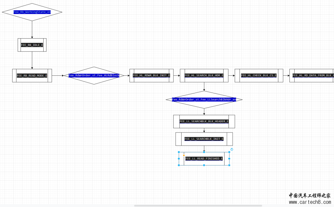

这个函数里面每个调用的子函数都有自己单独的状态机,调试的相当头疼,不过结束再回来看,发现其实状态机的跳转过程全部是一样的,大致如下:
Init→Search→Read→Read_Wait→Finished→Init。
在读到数据之后,则调用 Fee_UpdateStatus() 修改状态机,结束当前block读取,进入下一个block或者全部读取完退出while循环。

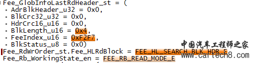

FEE_HL_RDWR_BLK_INIT_E
获取Fee_OrderFifo_st中当前需要读的block的PersistentId、lenth和Flags
,赋值给Fee_GlobInfoLastRdHeader_st。
然后设置Fee_RdWrOrder_st.Fee_HLRdBlock状态为
FEE_HL_SEARCH_BLK_HDR_E 去查找block的头。

1.Fee_RdWrOrder_st.Fee_LLSearchBlkHdr_en
执行Fee_GetMostCurrentSectorIdx()获取当前的使用物理块,
然后调用 Fee_LLGetAddressFromCache,获取block的地址给到结构体Fee_RdWrOrder_st。
其中,Fee_Cache_au32就是 fee block的存储位置,在Fee_Init()时就已经设置好了。
如果我们曾经写过某个block,那么cache中存储的即为具体位置,如果没有写过,那么会有一个无效的地址
FEE_CACHE_TMP_INVALID_VALUE (0xCAFEAFFE)。

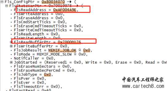

Fls_Read()。
不过这个函数也不是读函数,仅是在dflash not busy时,将地址偏移0xAF00 0000(使用的tc3**)后给到Fls_CinfigPtr。
之后调用 Fls_17_Dmu_MainFunction,到最底层的Fls_lMainRead,才是读函数。
首先确认 寄存器状态 HF_ERRSR、HF_ECCC,然后将ReadAddress的内容读到ReadBufferPtr的位置。
读完之后置位FlsJobResult为  MEMIF_JOB_OK,
那么Fee_CheckFlsJobResult 函数就会去设置
Fee_RdWrOrder_st.Fee_LLRdState_en 为 FEE_LL_READ_FINISHED_E。

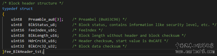

3.FEE_LL_READ_FINISHED_E
然后校验数据的头(0xA53C96)和 CRC16,之后
函数Fee_LLSearchSpecifiedBlkHeader返回FEE_ORDER_FINISHED_E,结束读命令。
设置 Fee_RdWrOrder_st.Fee_HLRdBlock = FEE_HL_CHECK_BLK_CS_E。
block header结构体如下:

整个流程Fee的读取流程如下:
