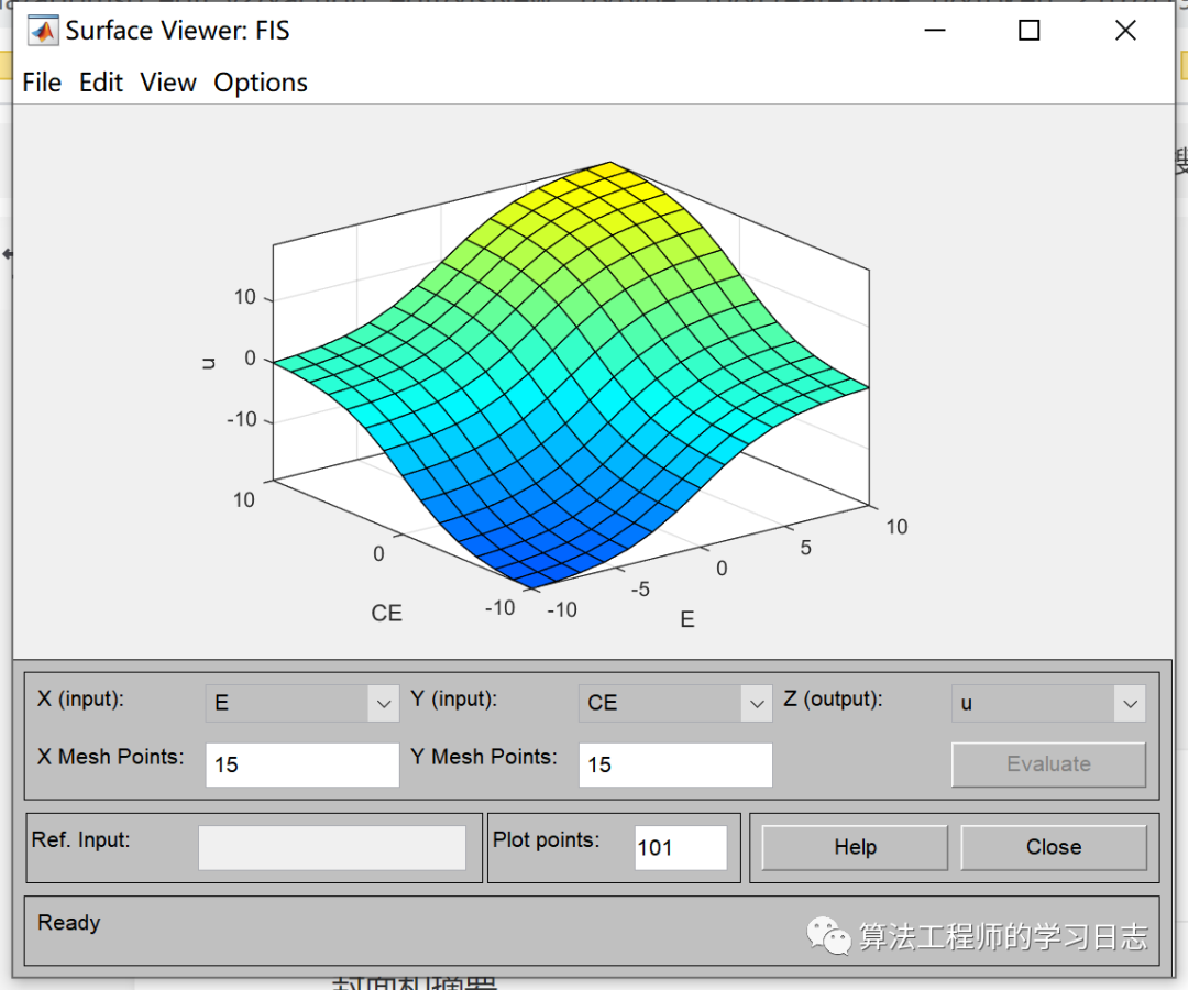

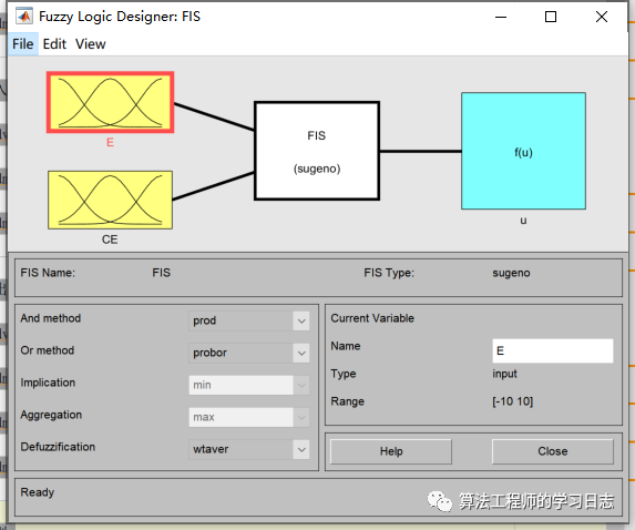

给出一个样例如下:
%%clcclose allclearFIS = newfis('FIS','sugeno');%%% 定义输入E:FIS = addvar(FIS,'input','E',[-1010]);
FIS = addmf(FIS,'input',1,'Negative','gaussmf',[7 -10]);
FIS = addmf(FIS,'input',1,'Positive','gaussmf',[710]);
%%% 定义输入CE:
FIS = addvar(FIS,'input','CE',[-1010]);
FIS = addmf(FIS,'input',2,'Negative','gaussmf',[7 -10]);
FIS = addmf(FIS,'input',2,'Positive','gaussmf',[710]);
%%% 定义输出u:
FIS = addvar(FIS,'output','u',[-2020]);
FIS = addmf(FIS,'output',1,'Min','constant',-20);
FIS = addmf(FIS,'output',1,'Zero','constant',0);
FIS = addmf(FIS,'output',1,'Max','constant',20);

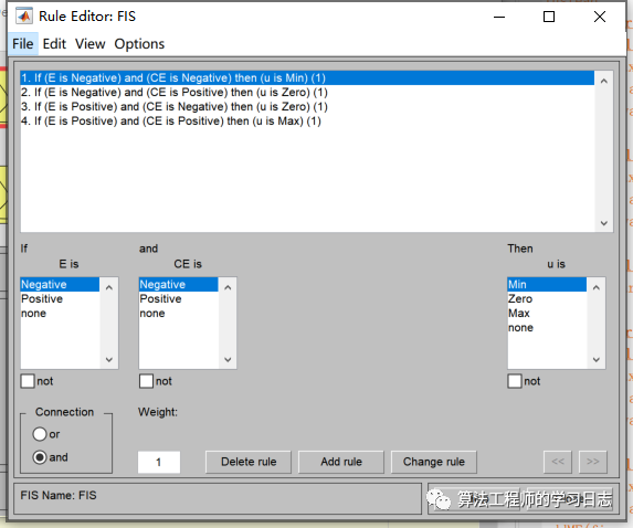

%%% 定义规则:% 格式:输入1~ 输入2~ 输出~ 权重(默认为:1)逻辑关系(1=and;2=or)ruleList = [11111;...   % Rule 1
12211;...   % Rule 2
21211;...   % Rule 3
22311];         FIS = addrule(FIS,ruleList);
