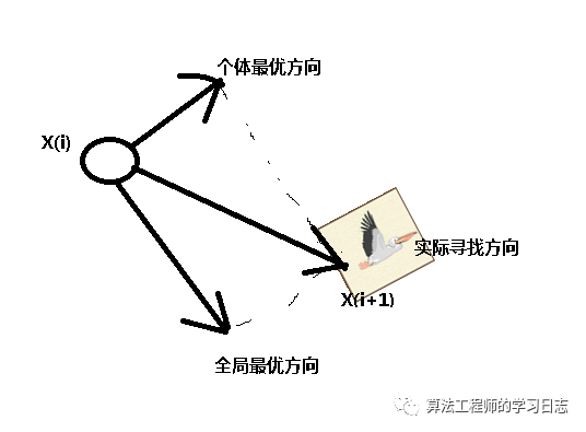

从上面的速度V的更新而已看到,c1那项就是朝着自己的最优解前进,c2那一项就是朝着全局最优解那前进。用简单的图表示如下:

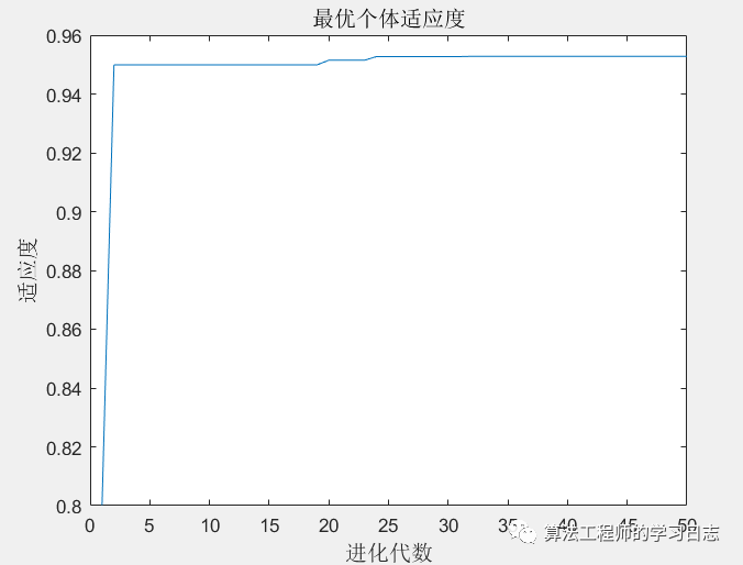

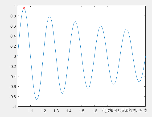

%% I. 清空环境clcclearclose all%% II. 绘制目标函数曲线图x = 1:0.01:2;fun = @(x)sin(10 * pi * x) ./ x;y = fun(x);figureplot(x, y)hold on%% III. 参数初始化c1 = 1.49445;c2 = 1.49445;maxgen = 50;   % 进化次数  sizepop = 10;   %种群规模Vmax = 0.5;   %速度的范围,超过则用边界值。Vmin = -0.5;  popmax = 2;   %个体的变化范围popmin = 1;%% IV. 产生初始粒子和速度for i = 1:sizepop    % 随机产生一个种群    pop(i,:) = (rands(1) + 1) / 2 + 1;    %初始种群,rands产生(-1,1),调整到(1,2)    V(i,:) = 0.5 * rands(1);  %初始化速度    % 计算适应度    fitness(i) = fun(pop(i,:));   end%% V. 个体极值和群体极值[bestfitness,bestindex] = max(fitness);zbest = pop(bestindex,:);   %全局最佳gbest = pop;    %个体最佳fitnessgbest = fitness;   %个体最佳适应度值fitnesszbest = bestfitness;   %全局最佳适应度值%% VI. 迭代寻优for i = 1:maxgenfor j = 1:sizepop        % 速度更新        V(j,:) = V(j,:) + c1*rand*(gbest(j,:) - pop(j,:)) + c2*rand*(zbest - pop(j,:));        V(j,V(j,:)>Vmax) = Vmax;        V(j,V(j,:)<Vmin) = Vmin;        % 种群更新        pop(j,:) = pop(j,:) + V(j,:);        pop(j,pop(j,:)>popmax) = popmax;        pop(j,pop(j,:)<popmin) = popmin;        % 适应度值更新        fitness(j) = fun(pop(j,:));     endfor j = 1:sizepop            % 个体最优更新if fitness(j) > fitnessgbest(j)            gbest(j,:) = pop(j,:);            fitnessgbest(j) = fitness(j);        end        % 群体最优更新if fitness(j) > fitnesszbest            zbest = pop(j,:);            fitnesszbest = fitness(j);        end    end     yy(i) = fitnesszbest;          end%% VII. 输出结果并绘图disp([fitnesszbest zbest])plot(zbest, fitnesszbest,'r*')
figureplot(yy)title('最优个体适应度','fontsize',12);xlabel('进化代数','fontsize',12);ylabel('适应度','fontsize',12);
结果如下

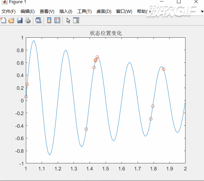

动画过程
