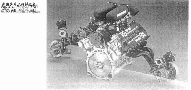

保时捷TAF涡轮增压F1发动机
 楼主| 发表于 5-11-2010 22:24:18 | 显示全部楼层
This causes a small loss in power that would not occur if the turbo had a power source other than the engine into which it is pumping. The power loss increases as the size of the turbo decreases, because the decrease size creats greater back pressure. Conversely, larger turbos create much less back pressure and therefore less powfer loss. The powfer loss inherent in a turbocharged engine is substantially less than the loss incurred by driving a supercharger with a belt or some other means.
这些导致功率上的一些微小损失,除非如果涡轮有发动机吸入空气的其他动力源,随着涡轮尺寸的减小功率损失增加,因为尺寸减小就会产生更大的背压。相反的,大的涡轮产生的背压小因此功率损失也小。涡轮增压发动机的固有功率损失要比由皮带或其他方式驱动的机械增压发动机本质上少很多。
