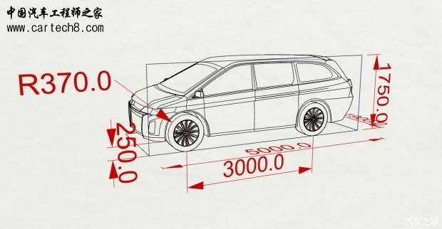

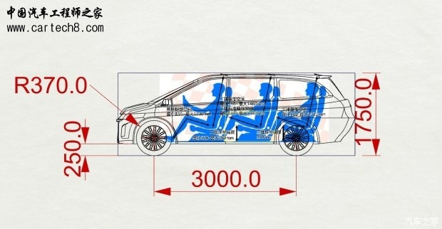

  1,MPV大小空间尺寸:
  车身长5米,轴距3米,车身高1.75米,宽1.9米,轮胎规格 235 70/R17,中规中矩,至于有人担心B柱和是否能放得下三排乘客呢,请见比例图:
getimg.php?url=http%3A%2F%2Fwww0.autoimg.cn%2Fzx%2FBlog%2FContent%2F2015%2F5%2F26%2F2015052616110072949.jpg
  三排座椅示意图
getimg.php?url=http%3A%2F%2Fwww1.autoimg.cn%2Fzx%2FBlog%2FContent%2F2015%2F5%2F26%2F2015052616152736887.jpg
  外观尺寸标注(单位MM)

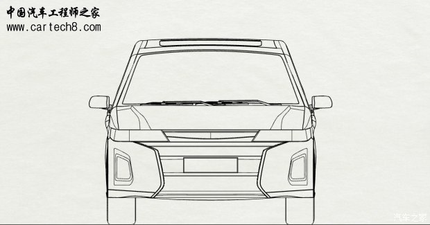

  2,MPV外观三视图
  在固定好全车尺寸以后呢,需要草稿绘出三视图,其实在3D化之前只有在脑中有其外观雏形。
getimg.php?url=http%3A%2F%2Fwww1.autoimg.cn%2Fzx%2FBlog%2FContent%2F2015%2F5%2F26%2F2015052616200821692.jpg
  前视图,锐角和直线为主。

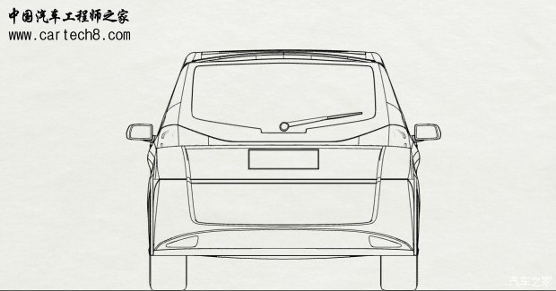

getimg.php?url=http%3A%2F%2Fwww0.autoimg.cn%2Fzx%2FBlog%2FContent%2F2015%2F5%2F26%2F2015052616222760561.jpg
  后视图,尾灯上移横直贯穿。

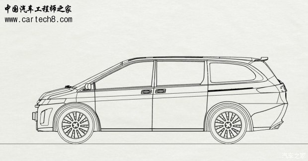

getimg.php?url=http%3A%2F%2Fwww0.autoimg.cn%2Fzx%2FBlog%2FContent%2F2015%2F5%2F26%2F2015052616231230046.jpg
  侧视图,头灯和尾灯一条腰线相连,车窗以宽大明亮为原则
