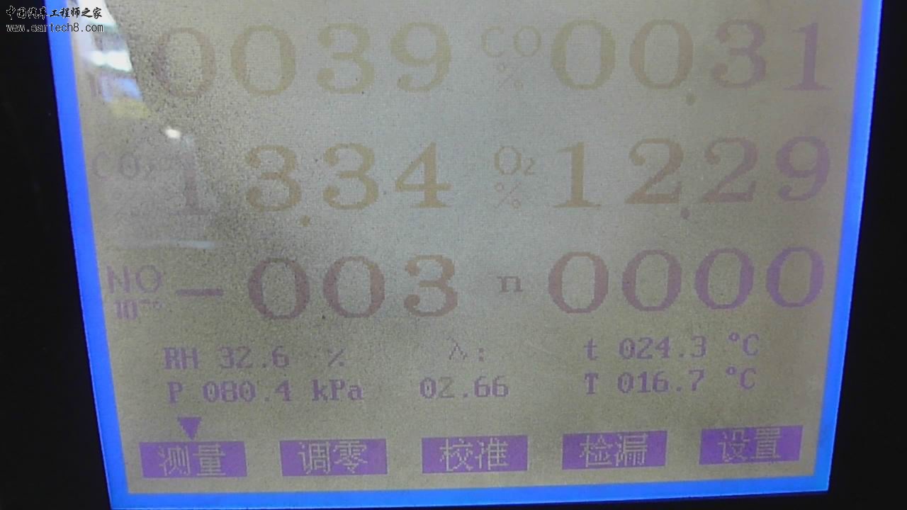

     楼主| 发表于 3-1-2014 09:40:08 | 显示全部楼层
    yanzi168 发表于 2-1-2014 19:14
    Thanks for your advs, I Do not have read much about firing, but i did some tests, it can not be st ...
    This is my experiment screenshots: LAMBDA=2.66
    发表于 3-1-2014 19:34:12 | 显示全部楼层
    How wanderful the measurement was!
    Did you measure the outlet of engine(exhaust mainford) with engine stable and combusting well?
    15-6-2015 10:44
